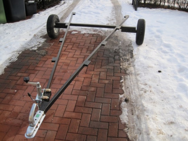

Postby BigAl » Sun Jan 10, 2010 10:38 am
Finally got around to taking some pictures of my trailer frame. It's hard to believe that 2 days ago this was a pile of unpainted steel section.
Image[/img]

Postby BigAl » Sun Jan 10, 2010 10:42 am
Is my jockey wheel in a suitable place? I put it 'outside' the A-frame to give unobstructed access to the little lever arm. Should I place it inside the A-frame?
Kind Regards, BigAl.
Build Journal on T&TTT
BigAl
Posts: 258
Images: 29
Joined: Sat Jan 02, 2010 4:42 am
Location: Glasgow, Scotland.
Postby Mini Renegade » Sun Jan 10, 2010 11:46 am
Loong good and light there Al. Leave the jockey wheel where it is, better for acces to the lock lever as you say, plus it frees up more space for gas bottle etc.

Postby BigAl » Sun Jan 10, 2010 2:18 pm
Hi Chris, I will try and come up with an actual weight so far. I need that information for myself anyway.
I'm going to be towing with a 2.0litre Diesel Toyota Avensis Estate (US:Station Wagon) so that ought to be similar in weight to your Focus pulling your Cal-erleggera.
Thanks Renegade, I will leave the jockey wheel there. :)

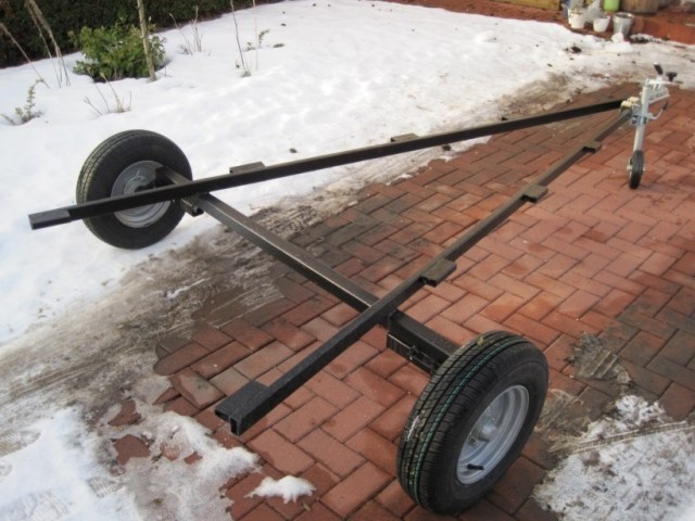

Postby BigAl » Sun Jan 10, 2010 2:53 pm
Thanks very much Dave! :) I'm a tiny bit concerned by the superlightweight-ness of the frame, but it's built now. I will just need to exercise some self-discipline with the weight of the woodwork to keep it light.
I have just been outside to weight the beast and the frame, wheels and all comes to 74lbs (33.5kg). About the weight of three or four bags of kittie litter! ;)
I did deviate from the Superleggera frame by using 500kg suspension and 145R10 wheels. The A-frame is a 61" Axle in 2inch square section and two 118" longditudinals.
It has been for a test tow today, and nothing fell off, exploded or burst into flames. So far so good.

Postby teardrop_focus » Sun Jan 10, 2010 5:20 pm
BigAl
:lol:
It would be natural to have concerns... but, remember that once the wooden teardrop structure (itself a style of monocoque construction) is bolted to the chassis, all will be strong and rigid.
73 lbs!!! Amazing. Well done, sirs; both you and Andrew for his conceptualizaccione. The automotive-application wheels and tires I want to use on my tear weigh 36 lbs EACH, but I am making these weight concessions to attempt to achieve a certain overall style concept.
I hope to bring my empty tear to under 500 lbs./227 kg so that when 400 lbs/182 kg of my camping gear is loaded on board the whole rig goes down the road at no more than 900 lbs/408 kg... Where my 70 lb deep-cycle 12V battery fits into the equation remains to be seen. Somewhere in the middle, both literally and figuratively...
