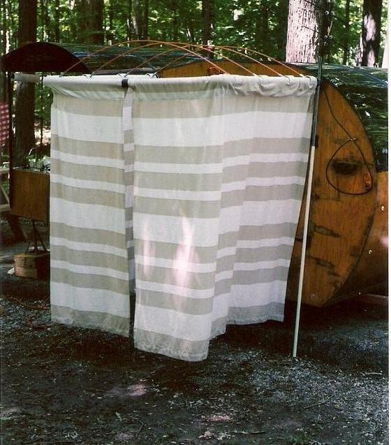

Postby bobhenry » Wed Feb 17, 2010 2:23 am
Instead of using the inner waterproof liner I used the fancy outer dress shower curtain. The heavier fabric curtain will stay in place better. One thing I did right was I had a 2 inch hem sewed in the bottom of the curtain and just slide it over the support rod this leaves the little button holes where the shower rings would be installed at the bottom now and they can be used with weights for windy situations

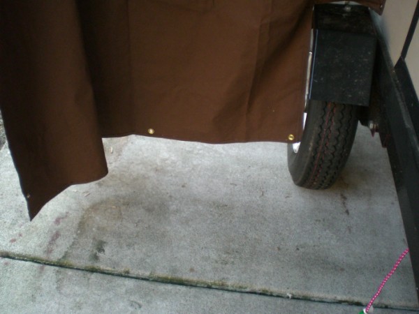

Postby fishfinder » Wed Mar 03, 2010 10:24 pm
I finally made my decision on what to do with the privacy screen material. I went to JoAnn's Fabric Store and bought some "duck cloth", borrowed the wifes Singer, and made up my own curtins. I made it so that the support rod slides into a two inch hem at the top. At the bottom I added some gromets for wind control. I also added some snaps at the edges adjacent to the trailer and also used snaps to hold the two center flaps together. I finished it late tonight and didn't get a chance to take any pictures. I will get them and add to this page.
Thanks for the ideas.

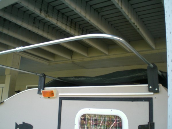

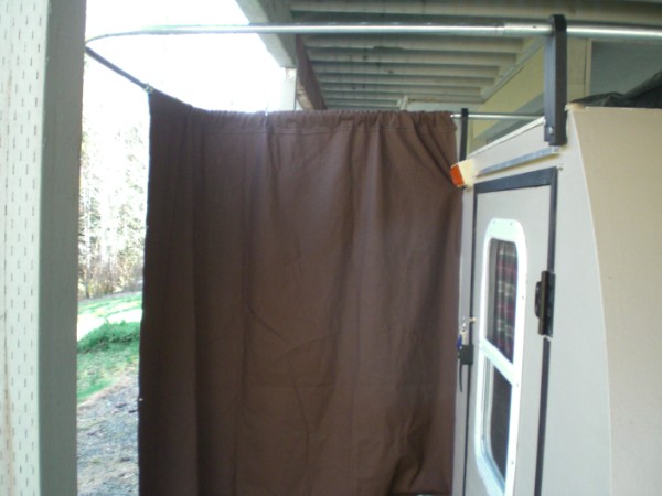

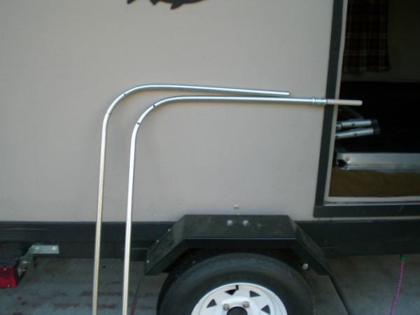

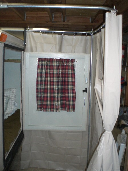

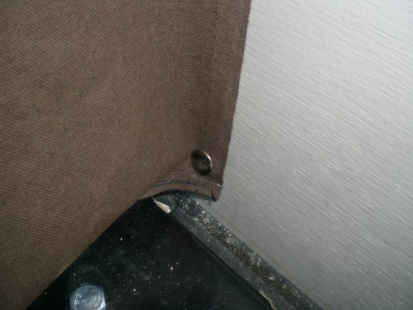

Postby fishfinder » Fri Mar 05, 2010 7:58 pm
Here a few pictures of my new privacy screen. I received a PM asking how I did this so hope these pictures will help.
First I have a luggage rack on the TD. The brackets are made of 3/4" hardwood and attached to the side of the TD with lag screws. The cross pieces are 3/4" electrical conduit. The curtin rod material is 1/2" electrical conduit which slides into to the 3/4" conduit.
I divided the hoop in half so it can be stored inside for travel.
Curtin material is Duck Cloth.
It has snaps which hold it to the sides of the TD. I also have tent poles in the corners (seen in privious photos).
And grommets in the bottom for tent stakes when necessary.
Now all I have to do is find some time to take her out. This retirement keeps me busy. :lol:

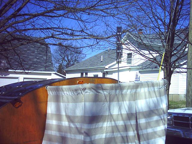

Postby Snide61 » Sun Mar 07, 2010 2:45 pm
It would look something like this. Except that I did not set it up all the way.
Snide61
Posts: 44
Joined: Fri Jun 19, 2009 7:33 am
Location: Ohio
Postby fishfinder » Mon Mar 08, 2010 9:47 am
Nice TD. Your plan should work just fine.
