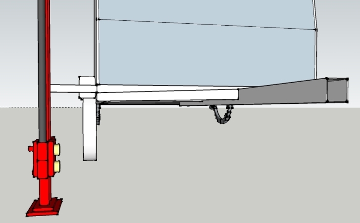

I was thinking of using the offroad type jacks to lift up the pod, needing just two and using jackstands to set the teardrop pod on. The lifting of the pod would be a two person job. The utility trailer will be 2"x2" frame with a 3"x3" tongue, and the subframe will be 1"x1" with 2"x2" ends. The exposed ends could also be used like the four corner hitch design.

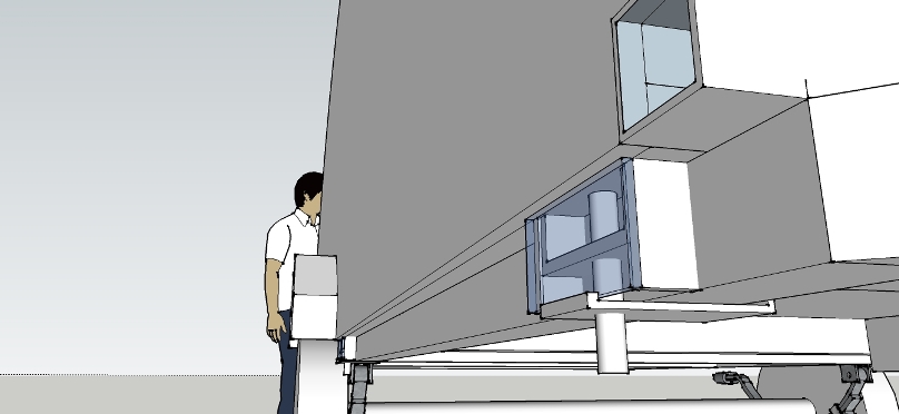

To connect the teardrop to the camper I have been thinking of the design below. This would fit into stake pockets on the utility frame with brackets that clamp it to the utility frame using threaded bar. Here is a SketchUp model (looking from underneath with parts removed for (hopefully) clarity).
I’d appreciate and comments on the design. I have looked around the site for a comparable design but I have not seen it executed quite like I would like (maybe I should take that as a warning?). I’m a little worried that this design will sound like a heap of rattling steel when traveling down a dirt road. Anyone know of wear strips that could separate the two steel frames? Maybe strips of UHMW plastic (cutting board material)?

Overbuilding, I'd say. The 1" longitudinal tube is so weak over the length of the body that I don't see much point in having it there - the body sides themselves will be maybe 10 times stronger. A plate at either end of the two jacking cross-members would carry the load into the body.
My first thought was to not make the jacking cross-members permanent - completely removable 2x2s wider than the body would avoid the sliding extension issue and those notches would be strong enough to carry the body weight. However making sure the body doesn't slip off the cross-members is probably harder than making the extensions.
You might be able to devise a simple loading/unloading routine that just involves tipping the trailer one way, putting stands under the up end and then tipping it the other way. Stick a 4x2 block in each end and you could gradually lift the body enough just by tipping the trailer - though it would be a two-person job.
If you drop the 1x1 tube you'll have wood to sit on the trailer frame and that sounds fine to me. Maybe a sliver of rubber would avoid fretting - old car tyre inner tube stuck with contact adhesive would be ideal.

Postby jnowis » Sun Feb 21, 2010 4:26 pm
Andrew, thanks for the input, I appriciate it very much, even though I immediatly jump to defend by design. I'm trying to walk the line between lightweight design and long-term durability and ease of use. I think that it will be a tough challenge to get a teardrop camper that can also be used as a utility trialer. It has to be easy to switch between the two uses, while still providing a lightweight trailer. I don't want something that is the worst of both worlds, but I also don't have the space for storing two trailers (maybe not event the space for one) but I do have the need(want?) for two.
I have struggled with the need for a steel sub-frame, but my main concern is connecting the teardrop pod to the utility trailer. With the stresses involved with holding the teardrop pod to the utility trailer frame at only a few points (right now I would have six, three per side), I am leaning to having a steel subframe over a wooden frame. Peace of mind with steel being more durable over the long haul.
I don't think I'll need the rear 2"x2" lifting point, as I won't need to clear the fenders at the rear. I could simply lift directly off the steel frame and set it up on a jack stand.
The idea for lifting the teardrop pod came from a slide in camper design, lifting off the corners. I looked into the jacks that are used for slide-ins, but offroad jacks have about the same lifting distance and they are multi-use. I wouldn't need both of them on most trips, but one could be handy. Here are two views (a little crude, but the idea is there):
I probably should clarify on the attachment bracket. I envision having six such brackets welded onto the 1"x1" steel sub-frame to line up with six stake pockets on the utility trailer. Overbuilt, probably, but I don't want to be driving down the interstate or on a backroad and suddenly realize I'll have to use the utility trailer to haul my once teardrop pod to the dump.
Does anyone have a different idea for connecting the teardrop pod to the utility trailer? I want something that is simple in its design and also relatively simple to detach from the trailer. I also need to have a certain amount of redundancy in the design, with offroad abuse in mind.

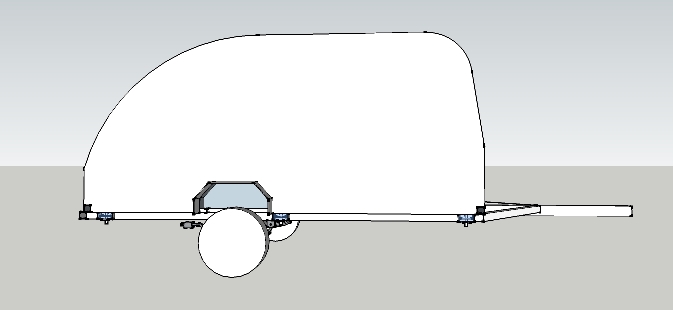

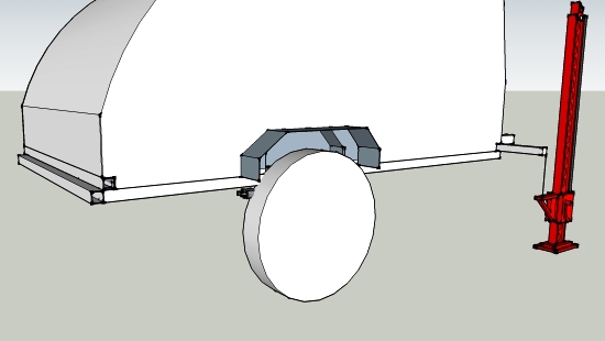

Postby jnowis » Sun Feb 21, 2010 9:47 pm
I worked on the SketchUp model a little bit. My earlier post did not show the correct overhang on the side. There will be about a 1.5" overhang over the utility trialer on each side. This view is trying to show how the bracket would look. The front face of the bracket is transparent to show detail.
And here is a side view
I'm thinking the sides of the teardrop will be wood with decorative trim. I might try to incorporate a wood molding to cover up the brakets and give the teardrop a more finished look. If I can pull it off, I'd like to have a Greene and Greene (California Arts and Crafts furniture) look to the wood trim, with cloud lifts.
