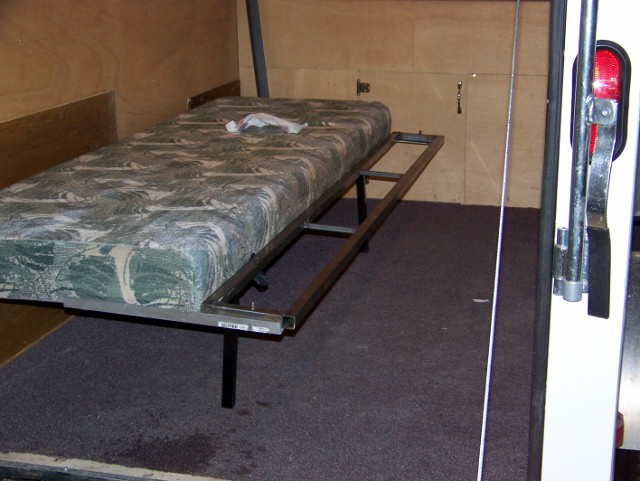

[color=green]Sorry I have not updated this in a while. But I pretty much finished it up and we even did a camping trip in it without real issues! Here are a couple of highlights.
The seating / bed for the wife and I consists of two “click-clackâ€
GaryDee

We did cheat a little when it came to the cabinets. We purchased pre-fabbed ones for the pantry and sink. A flat screen computer monitor sits on top of the fridge that hooks up to an old laptop for playing movies. There are mini speakers I picked up from Good Will (not pictured - two in the rear, one over the sink facing the couch) attached to the ceiling. A small amp powers them through the laptop.
The box that the refrigerator sits on has the 115V to 12V power inverter / charger and fuses for the 12V lighting.
Here’s is how the bunk area turned out for the kids. The brackets with the pins on the second bunk are for the ladder. I used a cheap folding ladder and cut the back legs off. It fits into the brackets and gets pinned. The neat thing, it can still fold flat for storage. The pantry to the right is the largest. The door is a single from a bi-folding door.

I love how simple
Postby Crazylegs » Fri Dec 03, 2010 3:11 am
Great job on the bed couch that is so simple. You Rock
I picked this up for 10$ at an RV shop and it works well but to narrow. I am working on it. I love your idea, "simple"
I just need to put my new extension on the back. I was trying to make it like th fold and tumble beds in the toy haller.
