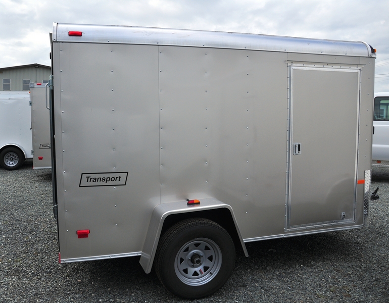

Thanks everyone and apologies for the belated replies. Since my initial post, I have decided on a Haulmark 6x10 CT with rear barn doors. The trailer will be officially ordered the 1st week of October once the car is sold (already have a buyer).
The only options I will be ordering is electric brakes and a 30x22 window to be installed at the factory. The reason for the factory installed window comes down to cost ($251.00) vs time and one less thing to work on. I still also have to decide on whether to go with the V-Nose or not. I am on the fence on this but leaning to ordering it as it is only $81.00 extra.
Once ordered, delivery time is 6-8 weeks so this makes it early December. In the meantime, we are still deciding on the floorplan and staying with the minimal concept.
The photo below is of the very same trailer (minus above options) we will be ordering. It is also the same color (champagne) which is hard to see due to the lighting when the photo was taken. The champagne color was chosen as it is the closet matching color to the TV which is dark brown.
Specs:
Exterior
Overall length: 14' (this could change if V-Nose is ordered)
Overall width: 92"
Overall height: 94"
Interior
Length: 10'5" (this could change if V-Nose is ordered)
Width: 68"
Height: 73"
Curb weight: 1100 lbs.
GVWR: 2980 lbs
BC_Explorer
