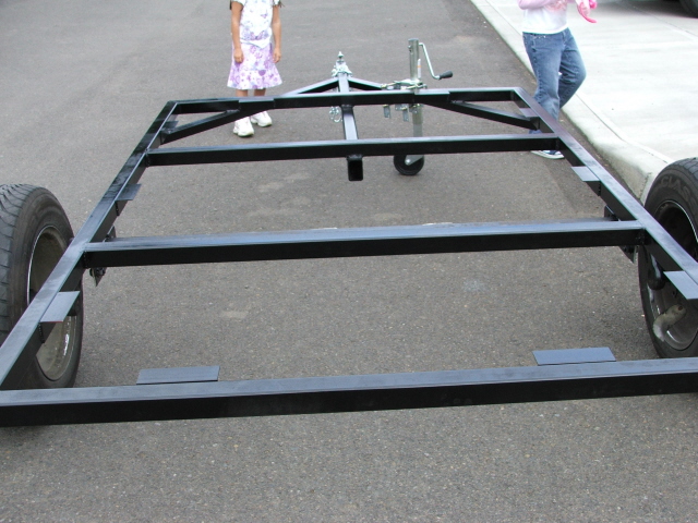

I had a frame made about 20 years ago. It is all 2x2 square tubing including the tounge, all ends welded closed. It was for hauling ATVs. I bolted the plywood deck directly onto the 2x2 frame. Some water did get inside the frame, I can hear it after the winter rains.
Bottom line, some rust but no burst tubing or any other problems. If you had mounting tabs or some angle welded on, you wouldn't need to drill into the 2x2.

Look here. http://www.tnttt.com/gallery/image.php?image_id=1993 You can see the "tabs" Norm is refering to on mine. I spaced 10 of them around the frame to bolt the floor to. Jim
