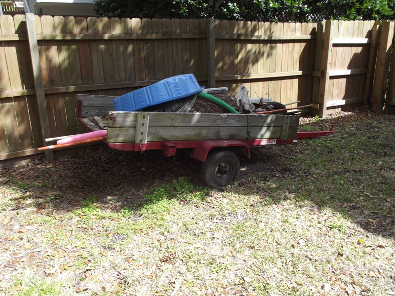

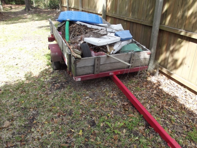

free trash with free trailer
This is what I found this morning.
trailer side trash.JPG (242.19 KiB) Viewed 5556 times

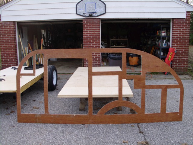

All 3 of mine were not an elaborate plan. The most I did was a full size profile on 1/4" plywood. I drew in all the important stuff on the profile template. I worked well.

Woodbutcher wrote:All 3 of mine were not an elaborate plan. The most I did was a full size profile on 1/4" plywood. I drew in all the important stuff on the profile template. I worked well.
Same here Steve........
Of course, even that changed!!
There were a few details that I had absolutely decided on before I started. The plan I used for the rest was to think it to death, talk it to death, dream about it, agonize over it and then usually do something totally spontaneous when I actually got to it. There are a few things I wish I had done differently, but for the most part I am very happy with my choices.

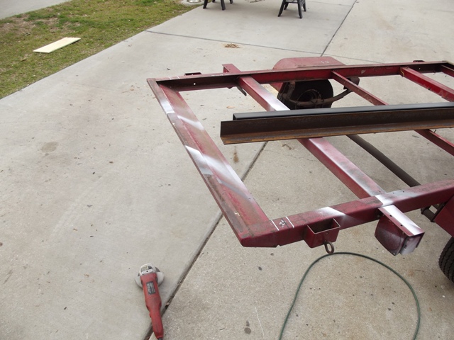

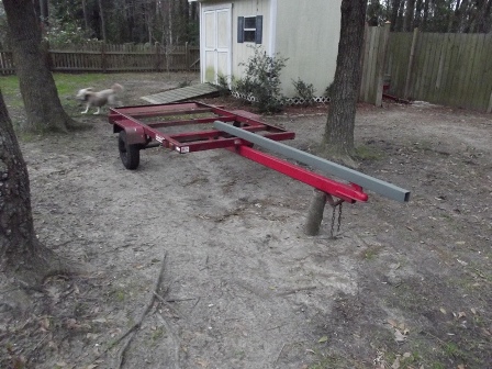

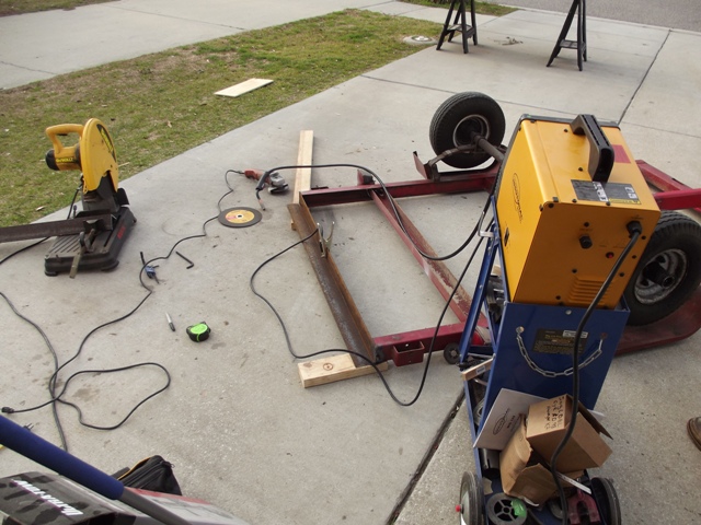

I took off work early this afternoon so I could make sparks on the trailer.... and I did just that. We had temps here in the upper 60's this afternoon so I felt the need to take advantage of that.
All the sharpie marks I put on the trailer are now battle scars. No turning back now.

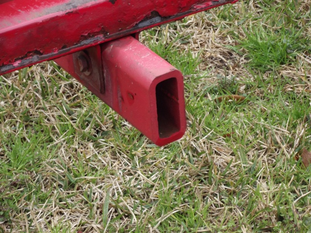

Hows this for a modified tongue tube? 3/8" thick box tubing.... over 100# on the bathroom scales. Unreal, no wonder hte guy wanted it out of the yard so bad.

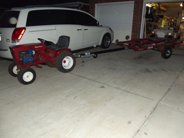

Tools, got to have tools! A lot of cutting, much more to come!
The ole Wheel Horse yard tractor doing what it does best! Next weekend, I'm going to flip the axle to the tops of the leaf springs, move the spring mounts up about 2"... to get the frame deck down 4-5". Right now, it's sitting 19" above the ground. I'm also going to clean all the utility trailer bracketry from the frame. Who knows, maybe I'll get lucky before next weekend & find an afternoon to bust more work out.
