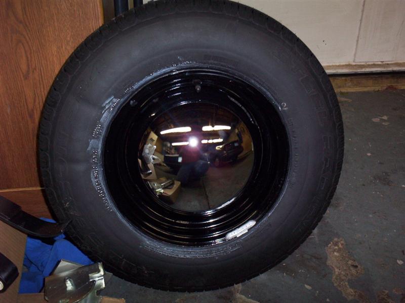

Postby Georgeandpat » Sun Oct 30, 2005 9:32 pm
Loader, Today I drilled and tapped four 1/4-20 bolt holes spaced evenly(and exactly)in the HF rims and inserted pan head bolts. I left about a 1/8" gap between the bolt heads and the rim. The baby moon snapped in place over the bolt heads. I'm having a little trouble editing my photos so I'll post them tomorrow. George.

Postby Georgeandpat » Mon Oct 31, 2005 12:50 pm

Postby toypusher » Mon Oct 31, 2005 12:55 pm
George,
They look great! I think that I would paint the wheels black or the blue to match your frame. Should look super.
