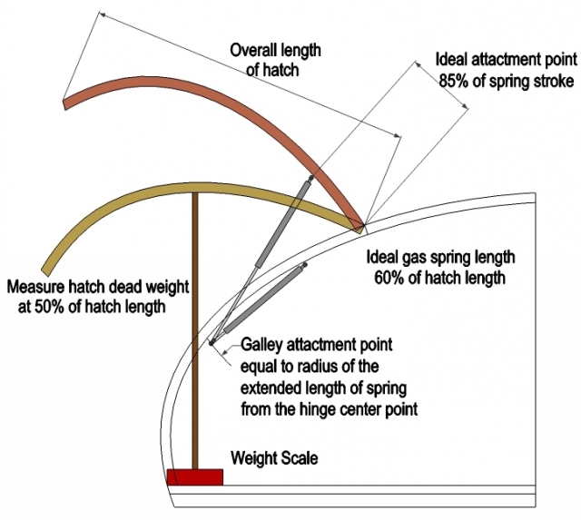

I have made a calculator to help determine the proper gas spring length, placement and force required to properly open and support my galley hatch. I searched the internet for formulas and recommendations for the proper placement of gas springs. This is what I came up with to use. I have not actually used it on my own trailer yet, but I figured I would throw it out there and hopefully it will help someone.
If you do use the calculator please post your results on this thread to help determine if it is accurate and useful.
Here is a picture that goes along with the spreadsheet below.
Gas Spring Calculator.xls
(25.5 KiB) Downloaded 12290 times
Hope it helps.
Dan

I updated the drawing and description in the calculator to help clear up some confusion on the spring attachment locations.

I updated the calculator due to an error in one of the formulas. This was causing the force of the struts to be twice of what they should be. I am sorry if this caused anyone to get the incorrect struts.
The calculator is now corrected and re-uploaded. If you had previously downloaded the calculator please delete it and download the new file.
Thank you to member ssample (Steve) for helping me determine that there was an error in my calculator.
