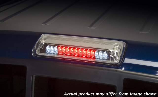

Has anyone tried using a third brake light on their teardrop that was made for a pickup truck? I'd like a nice third brake light for improved visibility with the added benefit of white courtesy lights to illuminate the area behind the trailer. This way, a third brake light would be clearly above my aft bicycle rack and the courtesy light would help loading/unloading at night (or even finding my dropped keys in the dark).
I'm thinking of using one like this made for an F-150
http://www.amazon.com/Putco-Pure-Lighti ... 98CNG7QQ6C.
I need about a 20-25 degree slope on the bottom side of it to fit the slope of my roof just a little forward of where the main hatch hinge will be and also no arch or camber on the front and aft edges since the roof has no side-to-side contour. Unfortunately, the sites that sell them only list the compatible truck models and maybe some general dimensions, but no details. The pictures are usually "typical" for some unknown truck model and not necessarily for a specific model. Maybe I could go out to measure the slopes on on the back edge of various truck roofs until I find one that works. :thinking:
I figure I can leave a cut-out in the roof to accommodate whatever depth it needs under the perimeter or bezel, but only about an inch deep. I'd also like one with a wire pigtail I can connect rather than a unique connector molded into its rear housing so I don't have to hack it to make a connection.
Has anyone had success with this kind of light usage?

I understand the need for changing the turn signal logic so the brake light functions correctly. My concern is more about the mechanical fit. I had been thinking about the one from R&P Carriages but I'd need to make a bracket with a vertical face and find a good way to seal the wiring from the elements and not catch lots of debris in the bracket (maybe a piece of aluminum angle with the corner facing up would get me part way there). That one also provides the running lights that I might need since my trailer may end up about 82 inches wide by the time I add fenders. I am also considering this one http://www.superbrightleds.com/moreinfo/truck-trailer-led-lights/braketurn-light-bar-tlb-r11/1027/
I like the looks and angle of the truck light in my original entry but I can't actually find it or what it fits, but it is used as a "typical" picture in many on-line stores. I'm on a road trip to Spokane this weekend so I'm finding that I'm looking at all the truck and SUV third brake lights to see what model might have the right slope for mounting such a light so then I could look up parts based on vehicle model. :thinking:
