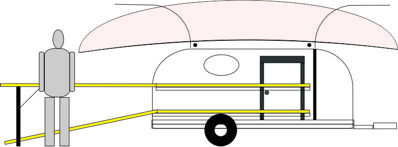

Hi!
I've decided to build a trailer. Several things came together to force the decision. First, I fly radio control airplanes and the planes were getting more numerous and larger, so much so that I had trouble fitting all my gear into the mini van. Second, my other hobbies are canoeing and wilderness camping. Lately, I've taken up cold weather camping. Now I used to go camping with my buddy who had a large extended Dodge van. We could fit all our gear and several boats on top. The van (AKA"the mothership") was also important as an emergency shelter when winter camping and was always snow shoeing distance away if something bad happened. The old dodge van finally died and was replaced with a small car. With mileage in the single digits, I can't blame him. So I decided it was time to act.
I had these requirements: 1.Be able to securely carry my larger aircraft. 2. Have racks on top for carrying several canoes and Kayaks. 3. Be able to function as a shelter when tent camping got too real. Here's what I came up with. I had an old HF 4x8 trailer that used to be my boat trailer for a wooden sailboat. Since the sailboat finally rotted past the point of fixing, the trailer was available. The camper will be 4'x4'x9 1/2'. I'll mount my Yakima racks on top for boat hauling. Inside I'll have two long sliding shelves for holding aircraft. The front will have a sealed compartment for gear and fuel. When the shelves are removed the inside will be available for sleeping. Drawing below.

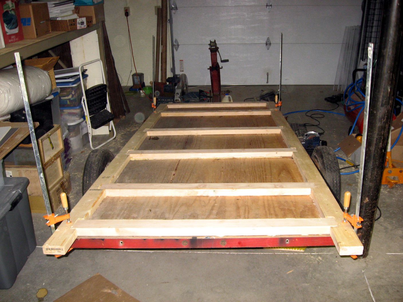

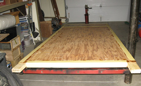

I started by removing the bunks and platform for the sailboat and treated any rusty spots with rust converter. I'm building a new torsion box platform with 2x4 framing with 3/8" ply glued and screwed down. The cross members were half lapped into the side rails. The laps dont go all the way to the ends to prevent water from getting into the joints. I got the cross members in and I'll add another 2x4 down the middle. 1 1/2" EPS will fill the voids. Once the top is glued down the platform should be fairly rigid.
Comments, suggestions, and criticisms will be greatly appreciated. I have an Idea of what I want to build but the details are still a little hazy.

PM ....as we’ve found over the years four feet wide inside is a little narrow in reality .. Fine for single occupant .. :thinking:

Agreed.
I had purchased an old 6 x 10 pop up for a good price with the idea of using that a the basis of a teardrop camper that could also function as a toy hauler. But the weight, cost and ease of towing were significantly higher. I figured that the smaller trailer would better fit my immediate needs.
Most of the camping I do requires a canoe, snowshoes or skis to get there anyway. I'm getting older though, so maybe "car camping" as I call it will appeal to me more in the future. I can always build a second, larger camper later.
I have some immediate questions about this build. I plan to cover the foam with canvas and TB II, wrapping the canvas around the bottom of the platform for strength and to cover the edges of the plywood base. My question is what, when, and how to cover the bottom. Plan A is to paint elastomeric roof coating on the bottom except for a few inches around the perimeter. Then after the canvas is on, paint those last few inches. I figured I could block it up on the trailer frame with 2 x 6s to access the edges, then bolt it to the trailer when it was finished. Is there an easier, smarter way to accomplish the same thing?

While many people build a wood frame for the floor, it is redundant, your trailer will do all the floor supporting you need, the only reason I can think of doing it that way for is if you plan on an insulated floor, even then 2\4s are super overkill for any tear, you could rip them down to 1x lumber where you need it.

rowerwet wrote:While many people build a wood frame for the floor, it is redundant, your trailer will do all the floor supporting you need, the only reason I can think of doing it that way for is if you plan on an insulated floor, even then 2\4s are super overkill for any tear, you could rip them down to 1x lumber where you need it.
The 2x4 frame is to get some insulation, plus I had that 3/8" plywood sitting around for years. Nice to finally use it.
I also made it heavy to have the option of carrying a small motorcycle in the trailer for solo river trips. I'll have solid wood for attaching tie down rings and a center track. (You need the motorcycle to get back to your car.)

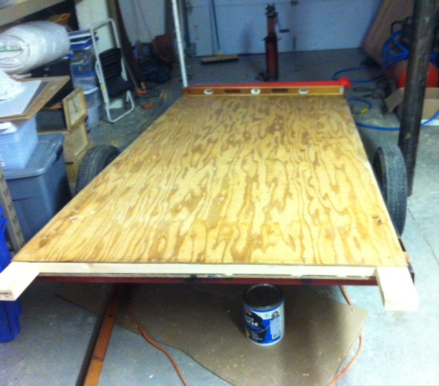

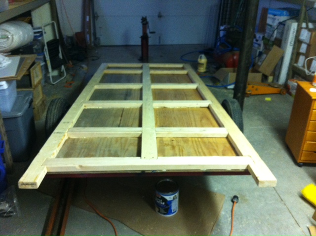

Postby Pmullen503 » Sun Dec 07, 2014 4:58 pm
Got the center member in, half lapped, glued and screwed. After the foam fill was added, I glued and screwed the top down. I spent some time with the level, jacking up a corner of the frame to make sure the platform was truly flat.
I'll flip it over and paint the bottom with the roof coating.
I was wondering if it would make sense to cover the edges first with a strip of canvas, coat the bottom and then flip it over. When I cover the sides I wouldn't go around the bottom, just trim the canvas at the edge. Maybe add an aluminum molding strip around the bottom edge. That would mean a layer of glued down canvas between the foam and the wood deck. That would allow me to bolt the platform to the frame instead of having to build the top of the 2x6 spacers as I originally planned. Any thoughts?
Oh, the rails extend past the back so I could add some kind of bumper/tie down points.
