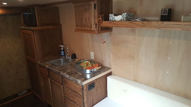

Here is a shot looking backwards down the drivers wall:Image
We found that counter space was a must. Nothing worse than these new campers that have a sink and stove next to each other and no where to put anything. I will be adding additional counter space via a tip down narrow shelf along the passenger side at some point.
In teh far back is a potti room with a microwave above it. So far, it has worked out very well.

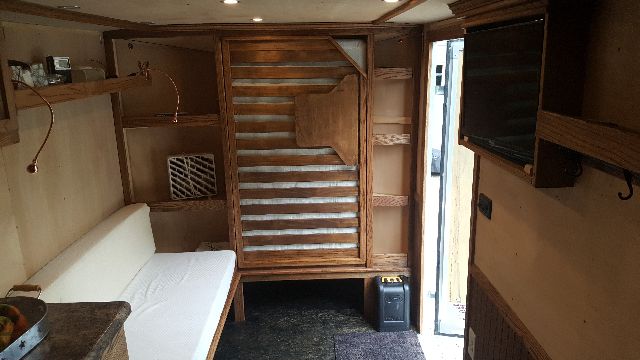

Postby Grummy » Sun Aug 19, 2018 12:16 am

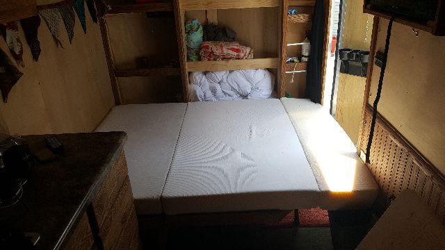

Here is a picture of the front bed system down. The 12" high backrest fills the gap between the tip down section and the door, though, I'm not one to mind my feet hanging over the end.
When I get a little farther along, I will pick material for the cushions and walls.

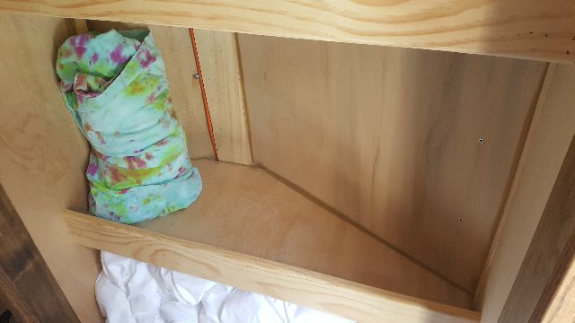

There is plenty of space on the nose shelves for more than just the bedding. Towels and wash clothes are easily accessible when placed on the top shelf.
Of course when the bedding is not on the shelf and the bed is down, other personal items can be stored there.

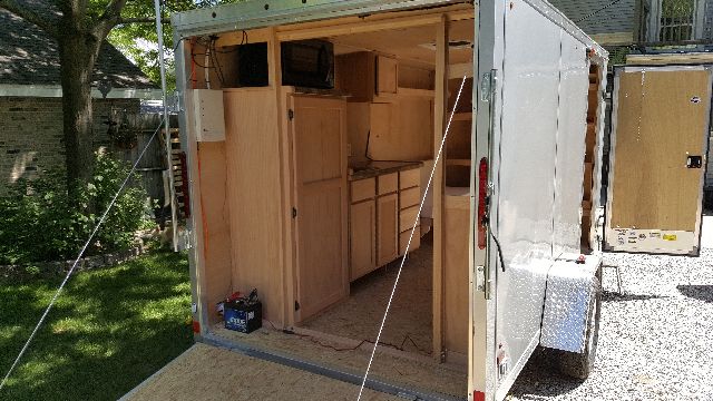

Postby Grummy » Sun Aug 19, 2018 12:33 am
Here is a build pic from the rear. I did use off the shelf base cabinets for the forward two units, but narrowed them as much as I could while still keeping all the drawers working. If I recall correctly, the factory left over 4" of dead space behind the drawers when they were closed. In a 7' wide, it would be use-able space, but in a 6' wide, I needed all the room I could get.
To save weight, I also removed large sections of the material between adjoining cabinets and made all three, including the "bathroom" enclosure I made to match, all connect together as one removable unit if ever necessary.
Microwave cabinet is on top of the "Bathroom", and my "load center" is located on the drivers side in an 8" "garage area" I retained in the back. The stub wall on the right side is removable in order to allow for cargo up to 48" wide. Two french doors with leaded glass will someday fill the gap between the bathroom cabinet and stub wall, opening outwards towards the deck (ramp).

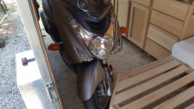

An early test fit of one of the scooters. I have yet to establish a proper tie down system for it, but will eventually. At least I know it will fit with bed deployed, AND still allow access to the counter area and bathroom when it is in place.

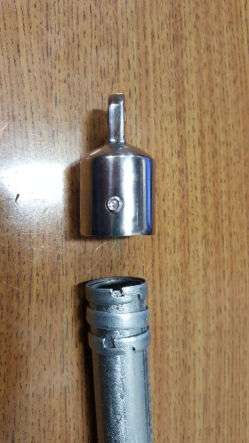

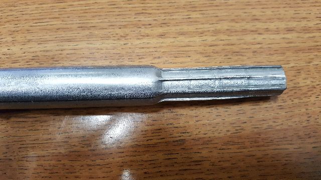

Here is a picture of when I was putting together something for an awning. My truck had what I call a rigid "swap meet" style frame system that could pretty much take any kind of weather, and I wanted similar here albeit a little lighter.
This one is attached via Bimini hardware to 3/4" conduit.
I found I could put 1" bimini ends onto the conduit by sliding a stack of 3/4" conduit compression rings into the 1" fittings and they fit like a glove.
To make the 8.5' tubes collapsible, I found I could fill the 3/4" conduit with 5/8" OD aluminum tube, the compress the ends down with a hydraulic fitting crimper enough to slide inside the next section.

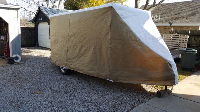

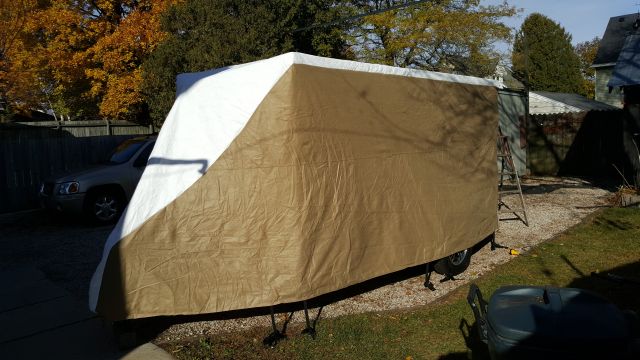

On and off over the last few days, I have started on a Winter Cover for my trailer. I really hated how my last rig always needed a thorough cleaning after the tree sap cycles and dirty snow. This year will be different (I hope).
I purchased a much larger Travel Trailer cover knowing I would need to cut it apart, then custom sew it together so it wouldn't be a baggy, floppy old thing in the wind. After grinding some of the very sharp corners from the upper trim moulding on the trailer, I was able to fit the white roof section, reinforcing the corners with an additional two layers of the same material. Then I fitted and sewed the sides on, picking and choosing the best fit apsect of what I had to work with... meaning, where to utilize the existing zippered openings and tie down straps as best possible. Both the passenger side door area and the rear ramp door area have zippered sections allowing access into the trailer without removing the entire cover. I may be able to keep it covered all the time when I am not using it, keeping me from having to clean it as much.
Here is a picture of the passengers side during just one of the many "fitting" events:Image
And, the drivers side:Image
Still a lot to do !

Thanks Hank... no on the parachute rigger...... I did spend 10 years in automotive upholstery work when I was young. It never left me, and I've always made sure I keep an industrial machine in my tool collection.
This particular cover is made from various thicknesses of TYVEK, so some of it I have used a standard household level machine. I use it where a zig zag stitch can provide more strength, but use the old Singer 111w155 (antique by todays machines) for all the heavy and thick work.
