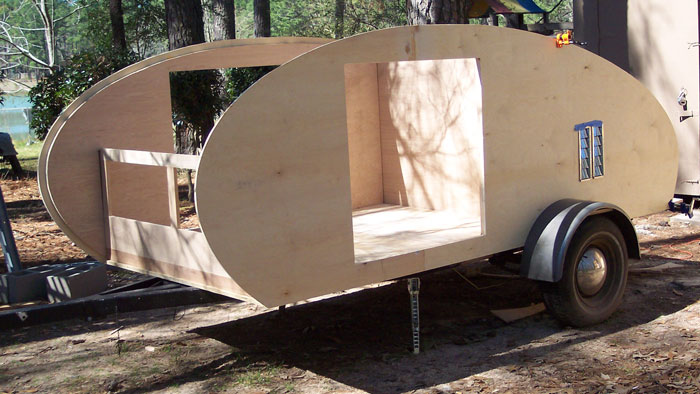

Have you got any more pics of the modernistic in your avatar. I'm building one very simular. And I'm also planning on the next one.

Thanks I enjoyed that very much. Very Nice. I like the kit also. Thinking the next one will be 4x8 simular shape. More offroad though. I'll take it when I'm by myself fishing or hunting, and don't need all the nicety's the boss want's in the one I'm building now.

How tall is your profile (referring to the Tear picture in your post.)?
