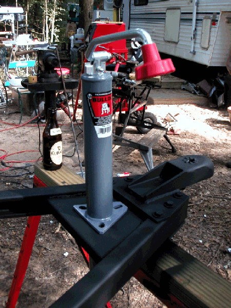

Postby Larwyn » Thu Apr 20, 2006 10:14 pm
Here's my version. Not as purty as the wood one though.

Postby owenmpk » Fri Apr 21, 2006 8:42 am
Larwyn wrote:Here's my version. Not as purty as the wood one though.
I do not think the beer bottle will take the tougue weight, better make it 2. :beer:

Postby Larwyn » Fri Apr 21, 2006 6:15 pm
I do not thing the beer bottle will take the tougue weight, better make it 2. :beer:
Never underestimate the power of a Guinness, that aint beer it's STOUT..!!! :lol: :lol: :lol: :lol:
