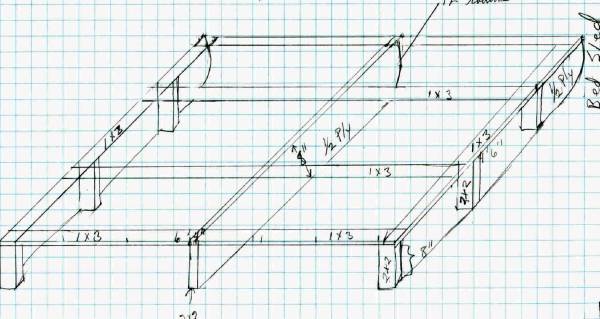

The raised bed idea. Does this look like it will work? It is made of 1x2" legs with 1x3" surrounding and slats across. The ply is 1/2" x 8".
Can I prep the screws in any way to allow them to go into the end of the ply sleds and provide support for the front ? (two layers of 1/8 I think)

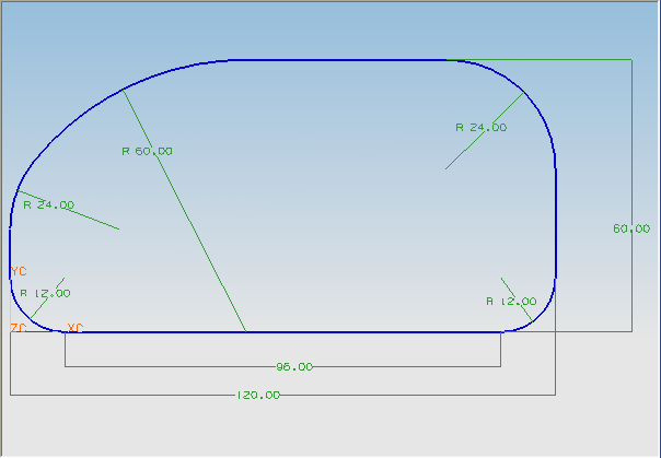

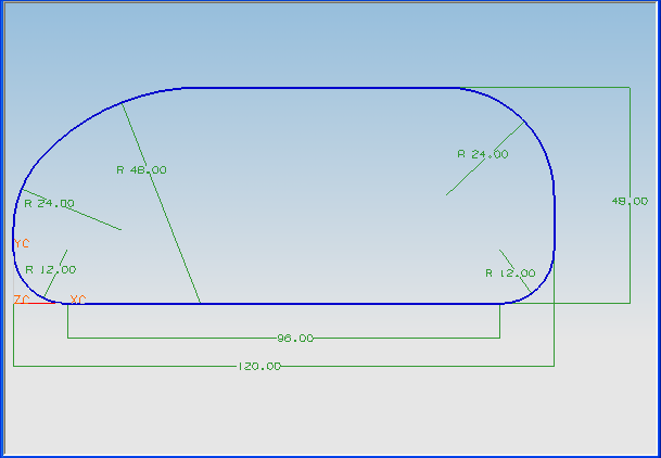

Postby mikeschn » Sun Jun 25, 2006 6:19 pm
Hey Miriam,
Like Paul, at this point I don't know enough about your design to give you a whole lot of information... :?
I looked at your sketch... and I looked in your album... and near as I can tell, you are doing a 10' teardrop on an 8' long trailer. No clue how high your sidewalls are.
So I did this sketch at 48" tall. If your sidewalls are taller, let me know, and I'll stretch it... BTW, that's a Benroy backend, with an extra poof on the bottom to get you from 8' to 10'.

Postby mikeschn » Sun Jun 25, 2006 7:14 pm
Miriam C. wrote:Can I attach a spar over the ends of the ply or should I use some board for framing the platform?
Thanks all
Miriam

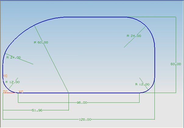

Here ya go... is this better?
Regarding your bed sled, I'm not sure I understand the question... If you are asking if you can just put two layers of 1/8" plywood over the front of the sled, my first thought is yes. I'm assuming of course that you have a subfloor to attach that 1/8" flooring to, and also that you have a spar pretty close to your bed sled.
Why are you using a bed sled? You are losing a lot of space... :?

That looks great Mike. Thank you very much. I think I ended up with the rounded end by trying to shorten the rear so the counter was shorter.
The raised Bed nets me almost an extra foot of floor space and gives me storage space.
I put curves on the ply hoping to give support to the outside covering. there will be a spar on bottom and above them I just don't know if it is worth the trouble of putting screws in the ply. They are only 8" tall.
Does the platform look sturdy enough? I am still trying to build a tank.

Postby mikeschn » Sun Jun 25, 2006 7:51 pm
Let's see if I have this right. You are going to put a subfloor on the trailer, put the bed sled on top of that, put plywood on top of the bed sled, probably access doors in a couple places...
Then you are planning on covering the outside of the bedsled with the teardrop sides...
And the front, top and rear with two layers of 1/8" plywood.

Postby mikeschn » Sun Jun 25, 2006 7:54 pm
Actually, you only need one more dimension... it's 51.96. You can call it 52".
It locates the center of the 60" R.
