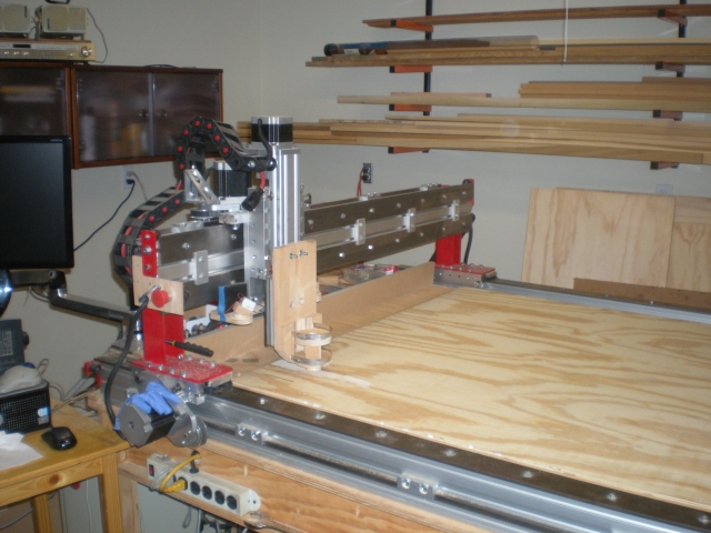

Postby capnTelescope » Sat Nov 23, 2013 5:07 pm
Hi Mike,
I built the CNC Router Parts CRP4896 kit. Aluminum extrusions with a steel weldment for the gantry riser. http://www.cncrouterparts.com/, http://www.cncrouterparts.com/crp4896-4-x-8-cnc-router-kit-p-139.html.
I will have had it 2 years in January. It went together in about 3 weeks, up and running. I have nothing but good things to say about them.

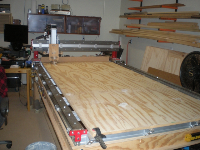

The machine often exceeds my ability to hold down the workpiece. I think I saw your machine on CNC Zone.
Brad

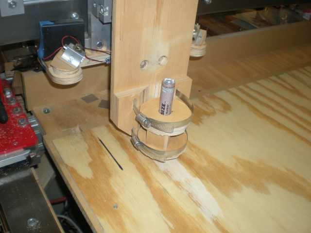

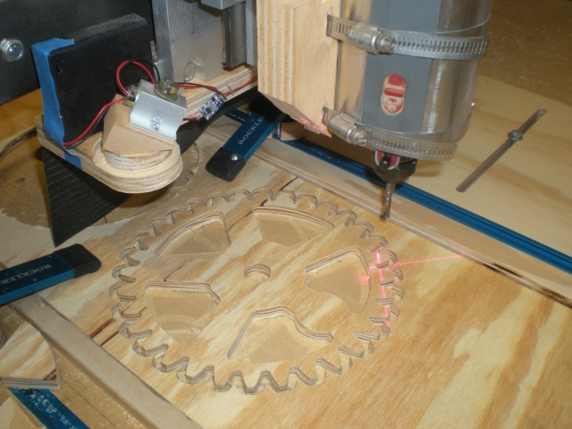

Postby capnTelescope » Sat Nov 23, 2013 8:24 pm
Mike,
I remember considering that router design you have. Black Toe, or something? I didn't really want to build from scratch. One company i worked for went off on a CNC conversion of a big lathe, and that went late and over-budget. And those guys knew way more about what they were doing than I did. Right about the time I was going to go ahead, CRP announced their kit. I held my fire until they got one working, and bought an early one when I saw it in action. I wanted a CNC to build a teardrop from scratch. I didn't want to build a CNC from scratch, based on that earlier experience. The Tear might never have gotten started.
The CRP4896 is open source, BTW. They have(had?) free plans and sell components.
Pix!
Cutting a wooden gear
Waiting for G-code
drawing setup
Ready to draw on the wall for cardboard mockup
