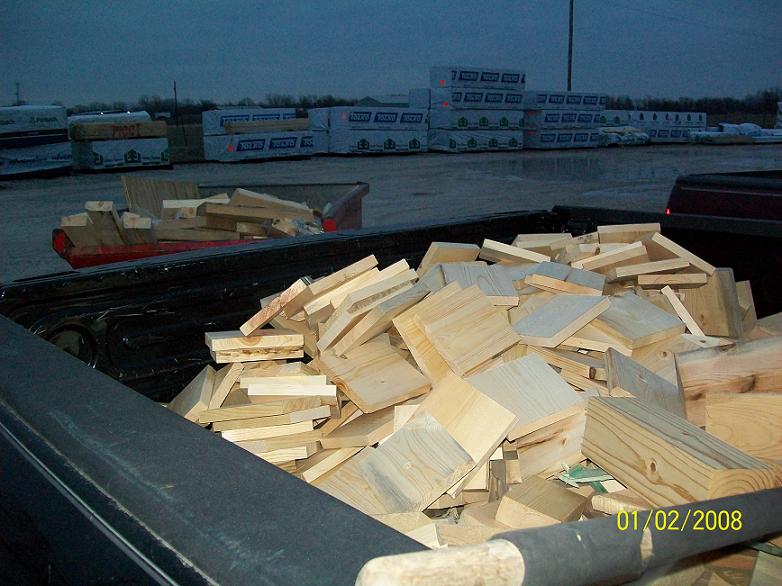

Well the flooring for the Caboose is decided. I was working
around the plant this past weekend and started cutting the plywood
bows for the sandwich roof trusses.
During my wanderings I walked by one of the cut off dumps
and picked up about four or five pieces of 1 x 6 waste and a
light went off. These are for the most part clear and knot free
SPF #2.
A Parquet floor using these cutoffs. :thumbsup:
I can trim them into 5 1/2" by 5 1/2" tiles.
A little quick math and it comes out just under
800 tiles for an 8' x20' floor. A notched trowel and some real
good construction adhesive as the base and I think I will
experiment with sawdust and carpenters glue or perhaps
the dust and some fiberglass resin.
Any of the cabinet makers out there have a good recipe
for a wood filler.
I am thing 3 /16 to 1/4" grout lines. The final finish will be
a gym floor sealer.

Postby bobhenry » Mon Feb 06, 2012 7:44 am
Yes they are spruce pine fir cut offs. It is just the 1x4 and 1x6 you would get at the lumber yard. They will be places face grain not end grain and yes the finish will be the key.
I spent part of my weekend cutting the blocks to a true 5 1/2 x 5 1/2 as most were close to 6" +/- long. I have just under 300 of the 900+/- I need. I like free I am cheap and I think this will be a great looking and performing floor. A few well placed throw rugs to catch the incoming dirt and abrasive sand and I think it will prove to be a fairly durable material.
If not it can be another layer or I can remove it and start over.
I hope to take a 4x4 piece of plywood and adhere a few dozen tiles and make a trial piece to test a few Grouts. I really feel the grout lines are necessary first to keep the lines running square and to act as a sacrificial break point if the floor should flex.
I really should have cut the rest of my roof trusses this week but played with the floor instead. I guess it makes since in building to start at the bottom and work up :lol:

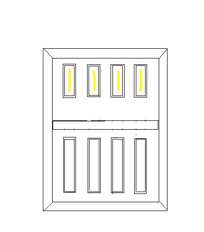

Went and played with paint a bit to draw up this.
The four little windows at the top I still have from the 4x7 build that I decided not to use.
The outer halo casing is 1x3 hardwood as is the center horizontal rub board. This would cover the skin and help to guide the door into the wall pocket.
Add a little fancy moldings around the windows and make mock panels below and this is kinda sorta the idea :thumbsup:
