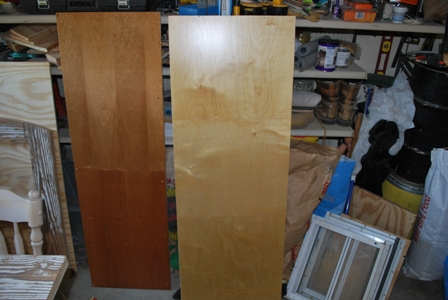

So, after making a 9 1/2' piece of luan for my canvas, I drew the outline up, then taking Mark's idea, drop the frame down to "set" my headliner on. Used pocket screws to join my frame work (will go back and glue / screw for final assembly), boy-o-boy I like that Kreg pocket hole jig I purchased with my Christmas money (hoping to pick-up corperate sponsorship my mentioning name).
As of last night I have one wall framed and all but one piece for the second wall. I used 1x4 treated for the bottom board that attaches the wall to the floor (why treated? because I had it) Actually I had all the pieces, but, while getting excited and cutting boards for the rear, Goof Ball chopped up the 8' 1x4 for the bottom of wall #2.

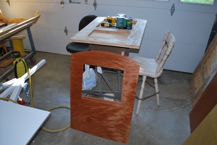

Postby WhitneyK » Sat Jan 15, 2011 11:01 pm

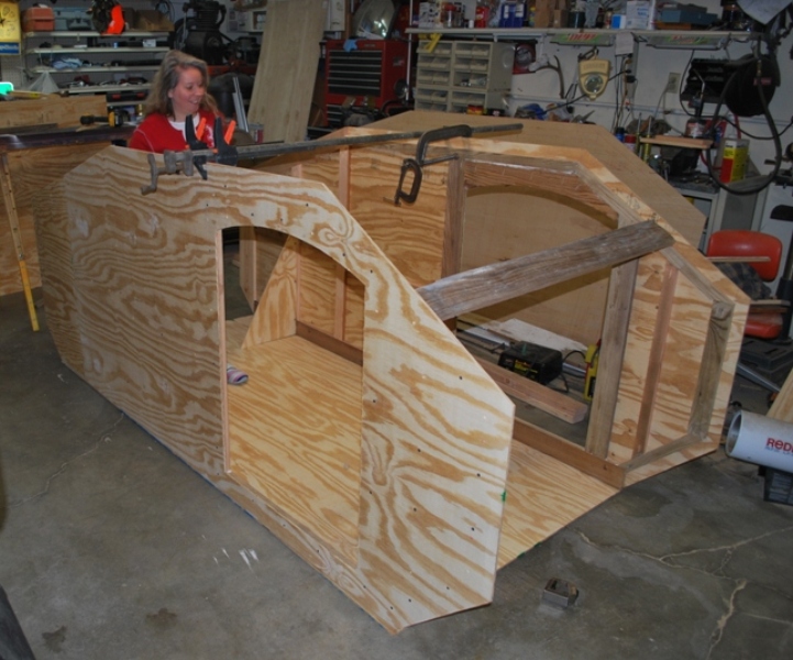

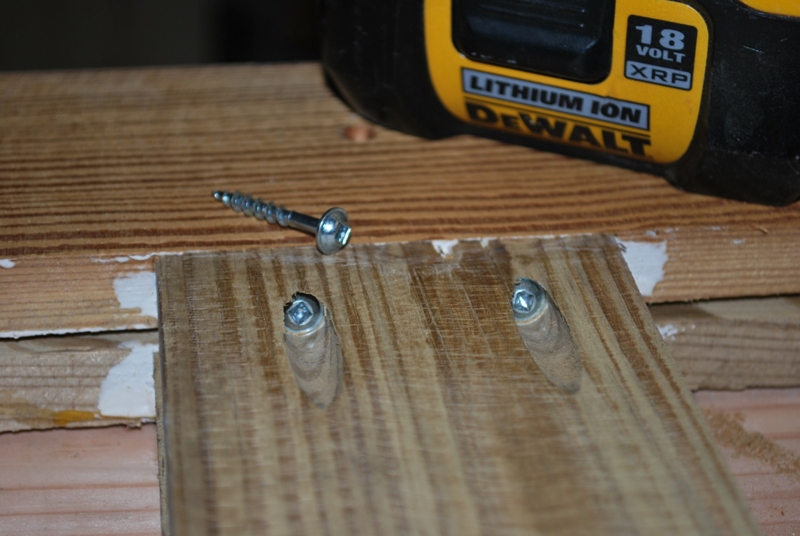

Well after getting all the wall framework cut and assembled to test "dry fit", I screwed the two profiles together to confirm the profiles matched, they didn't. I had to sand & trim slightly. (what else is new) Since I used what lumber I had, I then had to clean up the surfaces that would be glued to the ply later (notice varnish, weathering, paint, etc)

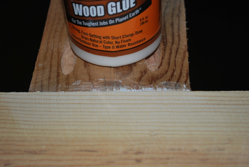

Then the frame was glued...

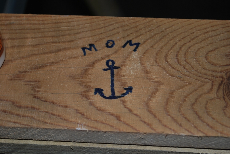

... screwed ...
... and yes, tattoo'd! lol (sorry, couldn't resist)
After calling it a night, I had to pick up my tools, set the walls to the side, and sweep up the mess so I could pull my wife's Blazer back in the garage. Anybody interested in and antique pump organ? I could sure use the room!
I'm kind of at a stand still until more funding is allocated to continue the project. Next will be the 1/4" ply for the outside of the walls. (still hoping for that Kreg Tool sponsorship)

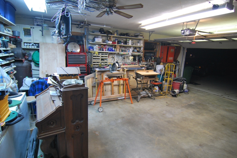

This is off-subject, but, is that an antique organ in your garage? Is it the kind that you pump with your feet? Is that another project, waiting in line? It looks like it might be nice. Is there a story behind it?

Sharon - Yes, that is a foot operated pump organ. It's in good shape, just got done with a minor overhaul to the inside works. No room in the house, would really like to relocate it to someone elses house. Story? Well on the part of the keys that doesn't show, the original builders signed their names to it back in Feb / March of 1878. in 1898 someone repaired & signed it, and in 1966. It was my b-i-l's that passed away 13+ yrs ago, just no room.

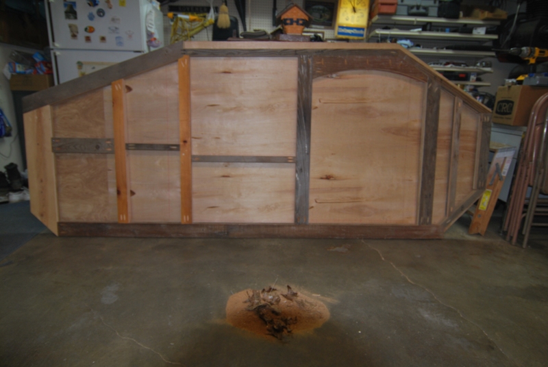

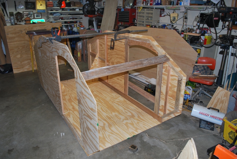

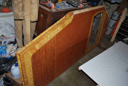

Postby WhitneyK » Sat Jan 22, 2011 10:19 pm

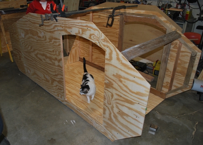

Well, I had Saturday all to myself, for the most part. I was able to get the 1/4" ply cut & screwed to my wall frames. I'll take it apart later and glue the ply to the frame along with the screws.
I stood them up on my sheet of 3/8 ply to test if 4' wide would be enough?
My wife brought out or 20 lbs of love out to verify the build by subjecting it to a cat scan
While wifey was in there, I snuck a pic, it's almost a standy for her, lol!
I talked her into laying down side by side with me to check the fit of a 4' wide (which was my first choice of size due to cost & easier to build). After being shoulder to shoulder and pretty well wall to wall, I think I'll make it a 5' wide. Might keep peace and after the first use say "Man I wished I would have made that a 5 wide".
My intentions were to use 3/8" ply over 1x framing & foam for the floor. Since I am going 5 wide, I will need another sheet of 3/8 ply, (delay of game, RATS!) Will 3/8 ply be sufficent for the floor? Can I get by with 1/4?

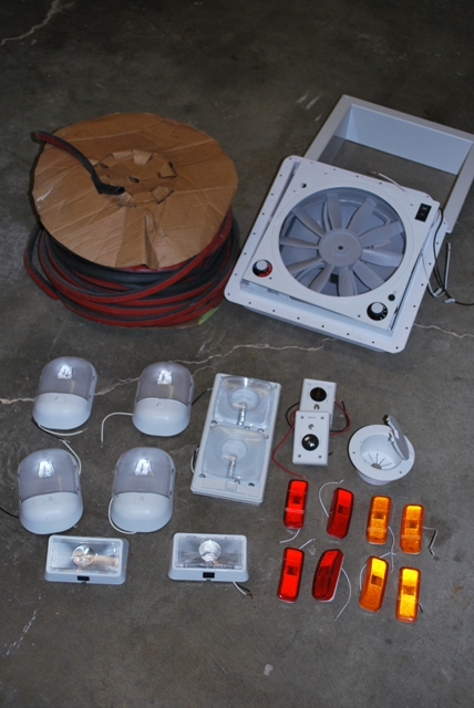

Went to the flea market in Louisville on an off month (we usually only hit the big ones 3 or 4 time a year), found a vender there from Elkart, IN that said it was his 1st & last time there. Well, long story short, he was selling surplus camper parts, WOO HOO! Left his booth with my wife & I loaded down for only $100 (blessing of the Lord!)
Fantastic vent (with electric lift by the way), int lites, porch lites, ext lites, 12V outlets, 110V access hatch. What a haul!

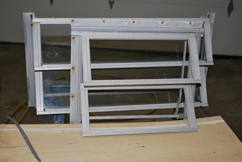

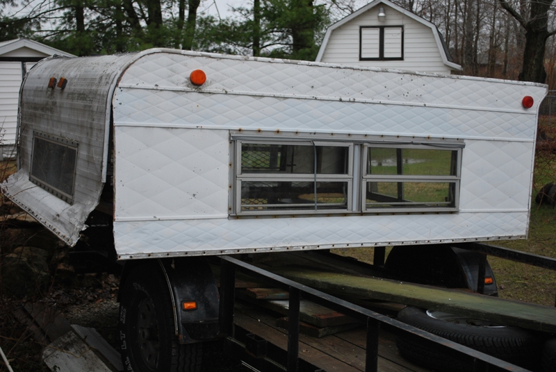

Was having problems finding windows, got hooked up with someone wanting to get rid of an old '71 camper shell with windows for $FREE.
So I drug it home.
After disassembling it, I had 2 windows on each side measuring 28" wide each. Hmmm, I need 18" wide, let's take it apart and cut it down, so, that's what I did.
So, after cutting them down, the neighbor that helped me brought 2 new ones over last week, go figure, but that's OK, I'll take the blessing.

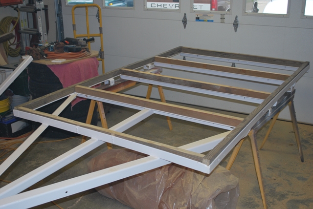

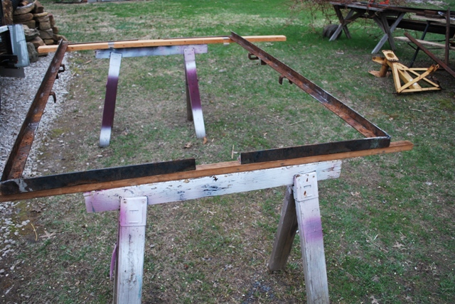

Postby WhitneyK » Sun Apr 24, 2011 10:16 pm

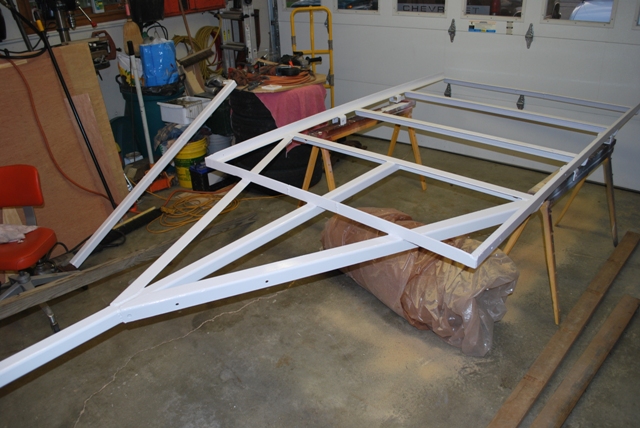

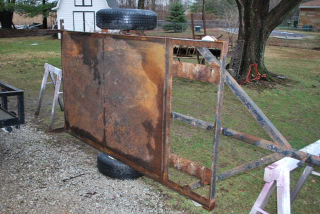

My brother "donated" (I think? Haven't discussed the title yet.?.) a 4+ x 8 trailer to the cause.

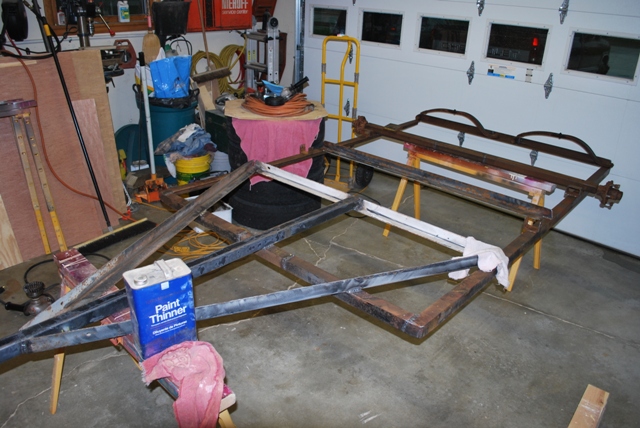

After I stipped it down...
I had to widen it to 5 X 8, but that's no problem, it's just cuttin' & weldin'
Now, that it's been widened & welded it's time to move back into the garage. It's ready for paint...
All painted up, ain't it purtty? Oh well, it's painted anyway!

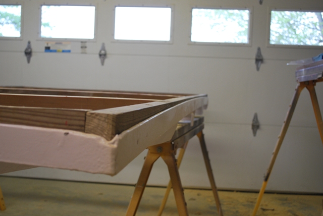

Rather than set the camper down into the angle iron frame, I added treated 2x's to it to bring it up level.
The trailer had been abused / overloaded in it's previous life (I hauled 3600# of gravel on it myself). The frame had a bow to it that I had to level out. Used treated lumber to do this, everythings good again.
I know, should have replaced the metal, but as I mentioned before, I'm doing this on an extremely limited budget.
Next stop, on with the camper progress ... stay tuned for more ... until next time ... same bat time ... same bat channel ... (showin' my age now ain't I)

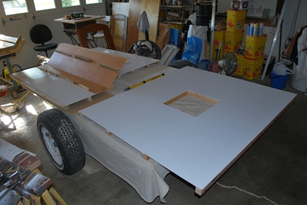

Postby WhitneyK » Sat May 14, 2011 9:30 am

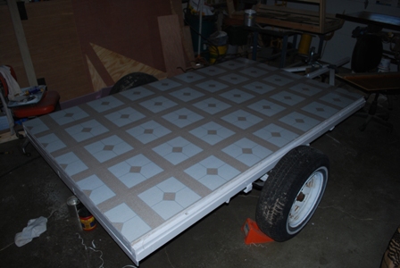

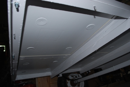

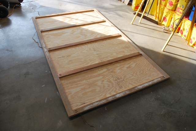

After painting the wood added to level the trailer frame, the floor is built,
painted, insulated, and attatched to the floor (got in a hurry, didn't take pic until attached). I added an extra brace up the middle just to take any "sponginess" out of it (I'm not mentioning using my Kreg Jig anymore, seems they're not interested in sponsoring me on this project). The insulation was glued & screwed, I made my own fender washers from some plastic panels I had laying around (about 2"). Since the glue I used stated it couldn't be applied over paint, I routed the paint off to expose the wood ?" from the edge (whatever the router off set it is) and did an X from corner to corner. Applied the glue (caulk type) in/on the groove, force fit the foam and put screws in just to be extra sure. Removed the plastic film from the foam and painted (2 coats) with Rustoleum gloss white, seems to adhere well and makes it a lot tougher. Filled any gaps/cracks in edges of foam with silicone.
Sealed the top side and applied tile.
In between the other little "hurry up and wait" steps (I strongly dislike [hate is such a harsh word] waiting on paint to dry!) I started staining, applying poly to the exposed interior wood. The large piece will be above the foot of the bed and extending to the galley area. The other (on the hatch frame) will be the top / door (trunk style) to the headboard storage area.
.......AND, while waiting on that to dry, I went ahead and primered the ceiling.

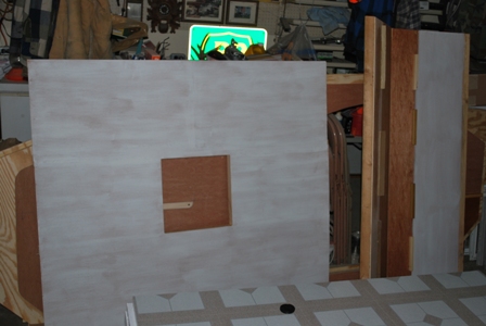

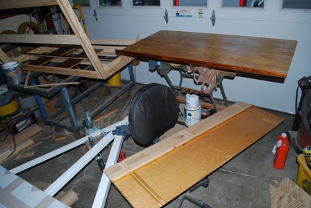

Life still gettin' in the way (two jobs, weddings, working on vehicles, stuff in general...). Well, I had the thing all together, then I took it apart to do the finish work. I've changed directions, originally I was going to put carpet on the walls, but, after speaking with Jarod at the gathering, talked it over with my wife and decided against it. Several reasons; not being able to get rid of the moisture (80-100% humidity in IN), a little afraid of it molding/mildewing, wife has allergies to that sort of stuff. I have no problem with folks that use carpet or cloth on the walls, gosh, was hopin' I could, would have been alot easier, but, just wanted to play it safe.

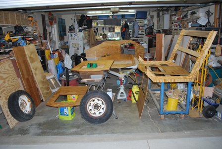

Well, since I hadn't planned on "finishing" the interior wood, I hadn't taken any extra pains to ensure it looked good. Should have used brads instead of staples, would have been easier to hide. Anyway, I got there and it's good enough.
Wife's getting into this build, she's buyin' all kinds of "nature" stuff to decorate inside with. Pretty cool stuff, I'll have to post pics. Probably won't even see the walls by the time she's done.
Put a final coat of paint on the ceiling, used Rustoleum gloss white (same as trailer), fiqured it would be durable and easy to clean (I'm not sure what I'll get on the ceiling, but I've got it covered).
Headboard (on left) & foot board finished and ready to go. The headboard will be part of the front storage trunk.
The interior is just luan, but ya know, it don't look to shabby when it's clear coated. Nice flames and tiger eyes?, this is one of my door panels
Walls, ceiling, floor, doors, head & foot boards, trunk lid at headboard, large storage shelf over feet/galley area ready for assembly. My wife was gone, my trusty neighbor was not in town, so, I guess I'll wait 'til tomorrow to assemble when I have an extra hand. All dressed up and no place to go :cry:
