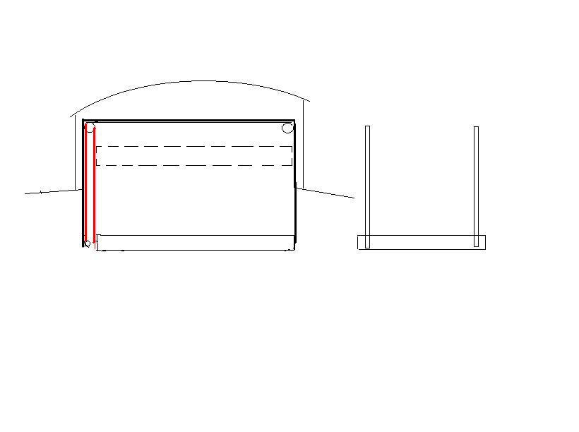

After being drywall lined the cupalo will be aprox 62" long by 81" side to side a queen mattress is 60" x 80" the bed with platform will be winched up into the cupalo for day time storage and let down into position at night.

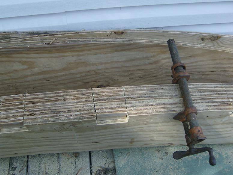

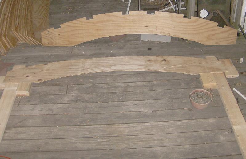

jigged up for the truss bents. Makes it faster easier and maybe they will even all come out alike :lol:
Just a closeup

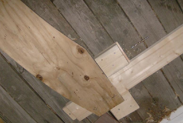

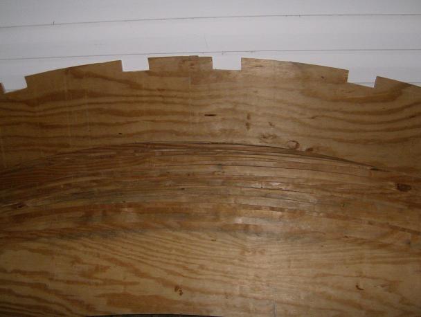

Made a pattern for the cut outs for the perlins that will support the roofing deck
Here you go they show up much better on the white siding.

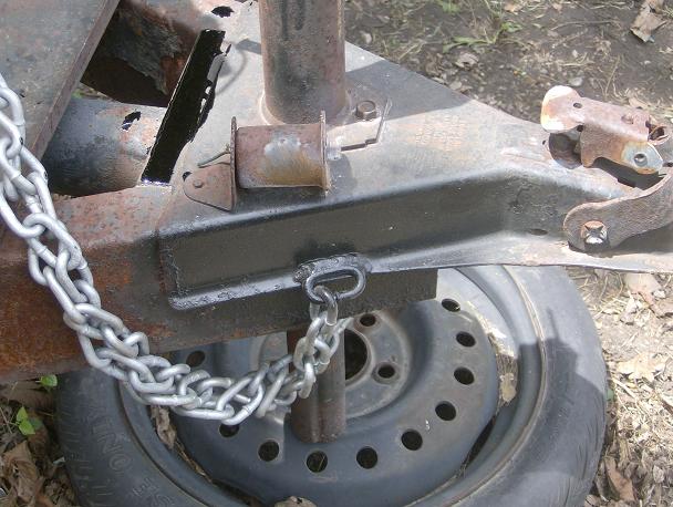

Trailer is going to a buddies for a weld job. We are extending the rear 30"-36" for the rear observation deck by welding on 2 1/2 x 2 1/2 square tube extentions. I will leave it with him and continue to build all the bents (trusses with legs) for the roof back at home.

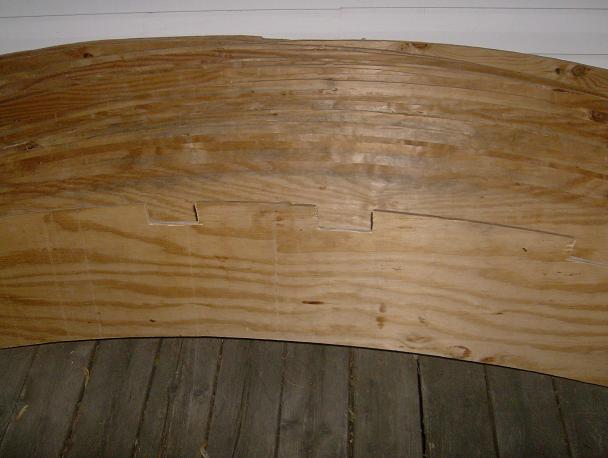

The Monday update pics may help clear up these questions. However you are correct there is a combinaton of flat bottom and barrelled trusses. The outer truss on each end mounted directly on the walls will be a flat bottomed 2 ply truss. The cupalo trusses will also be flat bottomed. The remainder of the interior trusses will be barrelled. The outer ( flat ) edge is at 7'6" and the top of the barrel is 8'1" (if memory serves me correct). I started cutting the pockets Sunday for the purlins that will run lengthwise to tie the trusses together and offer a surface to attach the roof decking.

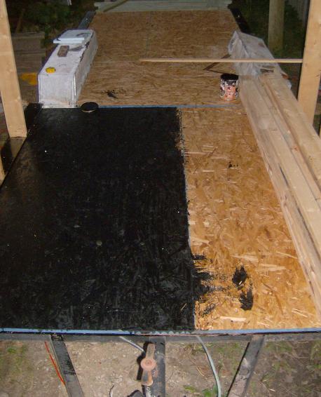

I coated all the 3/4" osb for the sub floor with waterproofing and they are ready to be cut and installed. Yes I will recoat any cut edges to eliminate moisture intrusion.

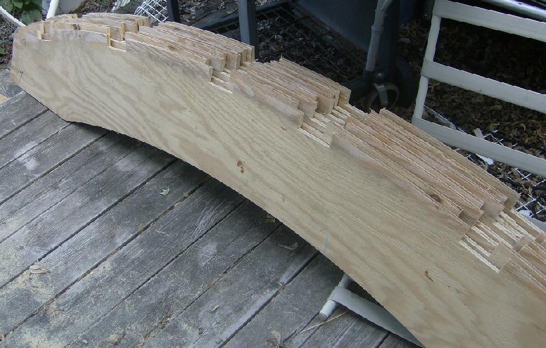

Trusses were ganged up making certain the index marks were all on the left side ( just in case they weren't cut exactly semetrical) and jogged even and them marked with the pattern truss.
They were marked using a framing square
and cut to 1 1/2" deep to recieve the 2x4 purlins.
I used the combination of my biscuit cutter and a jig saw to make the bottom cut.
They are ready to be sandwiched up and then glued and screwed with 1 1/2 spacers ( 2 x 2's)
to strengthen them and offer a attachment point for the purlins and the ceiling.

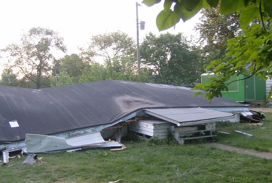

LOOK WHAT I FOUND :twisted:
less than a block from my front door.
The note pretty much says it all :lol: :lol:
Posts: 10355
Images: 2614
Re: Bob's caboose build
Postby bobhenry » Mon Jun 25, 2012 6:14 am
Monday morning update ! :D

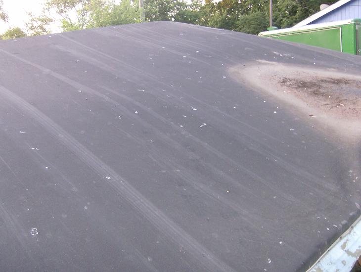

Well the rubber roof is safely loaded into my pickup after a call early Sat morning.

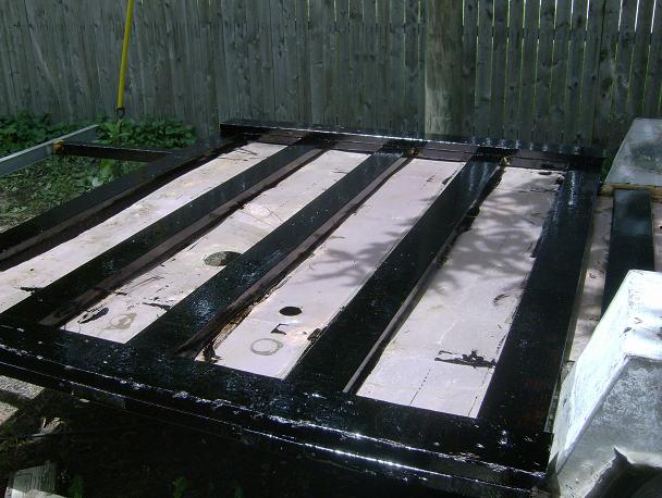

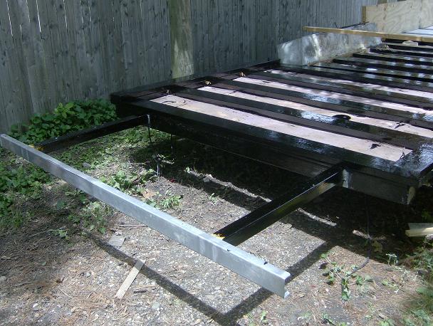

Finally got the frame back from my welder buddy early Sat A.M. ( just before the roofing call)
I reinstalled the rear floor joist and rim plate section that I had removed so we could weld in the observation platform.
here is the extention

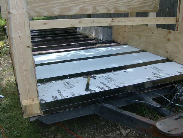

I decided to rewaterproof with this stuff
rear lumber now looks like this
here is a shot of the front ....it was removed , waterproofed with the black goo also and reinstalled then the 1 1/2 of foam insulation was inserted.

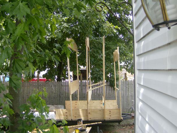

Here is a shot of the 4 trusses I was able to get reinstalled as they were removed to transport the trailer to get it welded. I thank my buddy Jimmy for his hour of help to manhandle them into place. (Yes #2 has the plywood truss mounted too high on the legs it will be fixed)
forgot to mention my welder also installed my safety chains

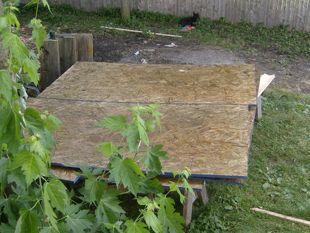

Sunday I finished installing all of the 3/4 osb flooring and removed the temporary bracing on the truss bents and installed drywall blocking to reinforce and straighten the truss legs. All four of the front ones installed are now true and correct. Only 7 more to go :roll:

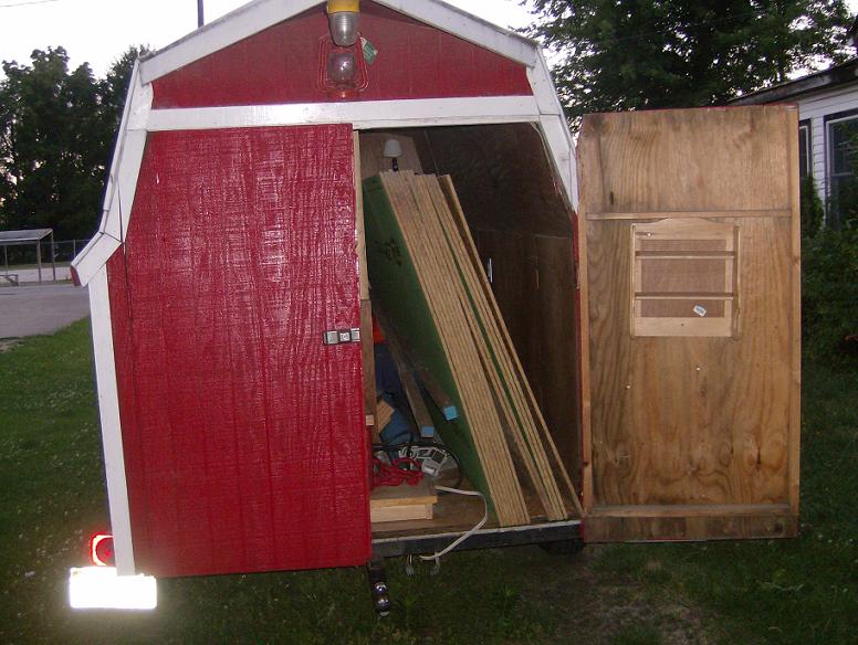

How about a most unusual Tuesday update.......
One of you made fun of my "storage shed" camper Look who is laughing now :D
The floor is down and was black gooping it until I ran out !

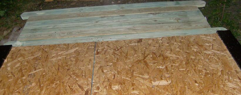

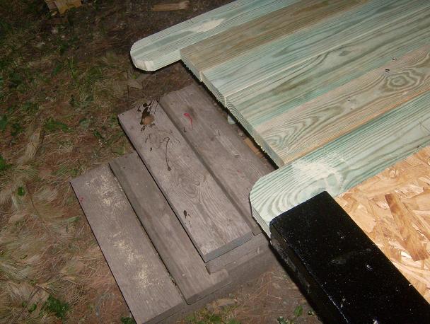

Cut and rough shaped the rear observation platform
even borrowed the barns steps to get an idea and they worked perfectly.
