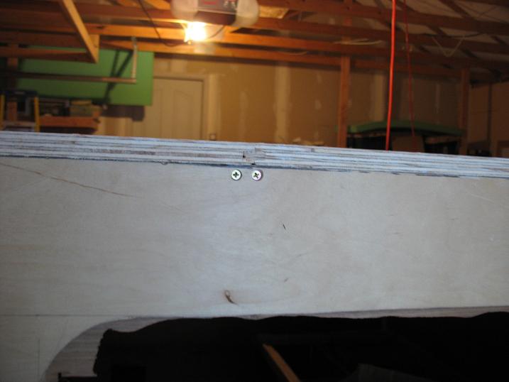

Postby Forrest747 » Sun Jan 15, 2012 4:05 pm
The roof is on. That was after I built Jennie some shelves for the kitchen. I had planned on using the spline methid of joinging the panels together. Did not go so well. I put the first one on glued and screwed it in place. The insulation did not compress as I had hoped so at the joint there was a 1/4 inch between the roof and spar. So I cut a four foot by 3 inch wide and slid it inbetween. I tried to add the spline and it just was not going to work. Removed and butted the panels together. With it screwed in place I the cut the spline in 9 inch lengths and hammered them in from the side put the first 4 feet in and then went to the other side and hammered the rest in from the other side. Repeated for panel joint # 2. Worked pretty good I think. Have to figure out to level the front end joint where it sticks up about 1/2 inch too high. Thinking of using the planer or the router I just don't know this is all new to me. With the doors I am going to start from scratch. going to use 1/4 inch plywood and then frame it out and then the cherry for the interior. will save weight, get the round porthole windows right.

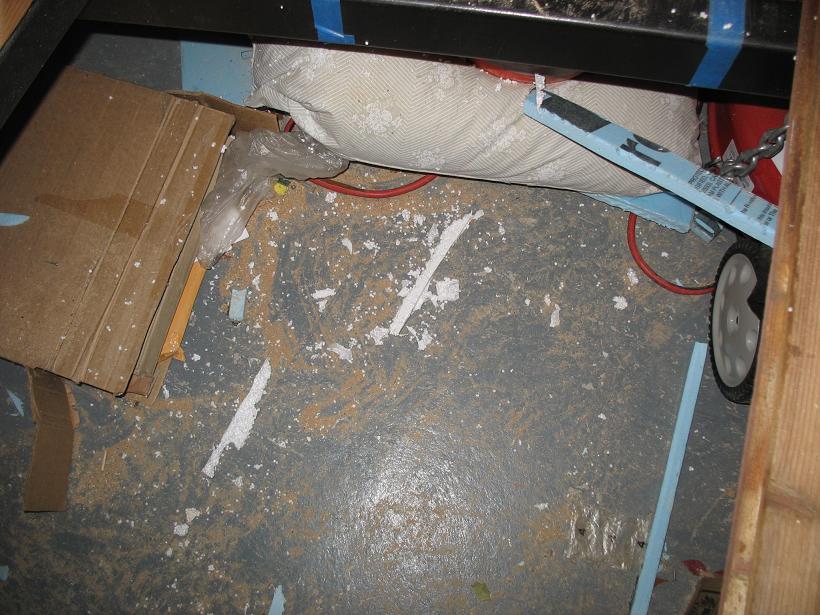

Postby Forrest747 » Thu Jan 26, 2012 12:43 pm
Here is some of the insulation dust from the white stuff and then some of the blue insulation. as you can see there is alot of difference. I will never use it again . I hate it more than fiberglass insulation and that is alot of hate.

Postby parnold » Thu Jan 26, 2012 12:57 pm
That's exactly what I need blowing around my driveway and yard... NOT!

Postby PSBreen » Thu Jan 26, 2012 7:34 pm
The weather has been slowing me down a bit so it's great to see someone making some progress. It's looking great.
I agree on the white foam. The plain foam without any backing just crumbles when you cu tor sand it. I prefer the pink or blue foam myself. They are both available in my area, but the pink appears to be available in more thicknesses.

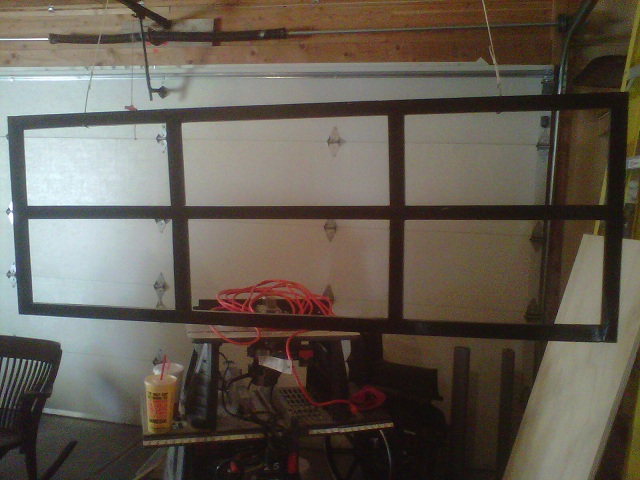

Postby Forrest747 » Tue Feb 14, 2012 5:50 pm
Here is teh inside frame for the shelfs. put the first coat of stain on them. thought they looked pretty good.

Postby Martiangod » Tue Feb 14, 2012 9:49 pm
Looking awesome, that cherry is beautiful.
