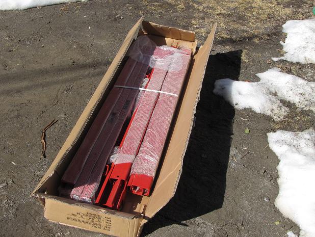

Well my annual bonus was 800.00 more than I expected so I went out and bought the 4x8 hf trailer and scrapped my ideas to build on my 39" x 48" hf trailer.

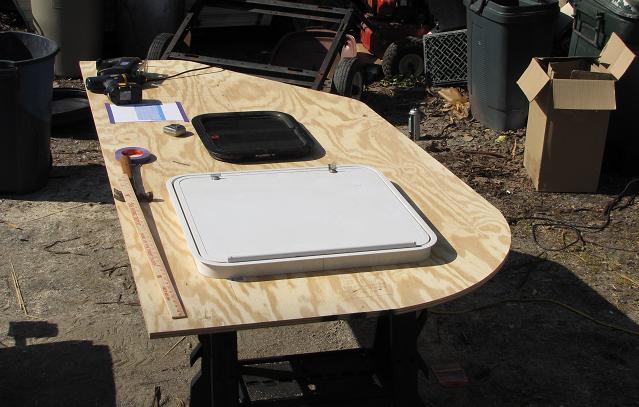

here's my windows and hatches from ebay

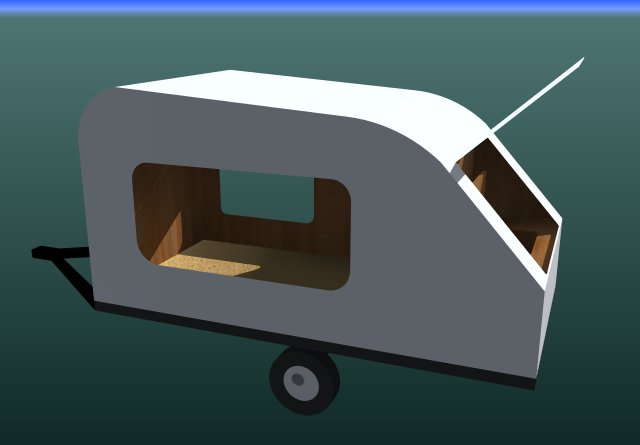

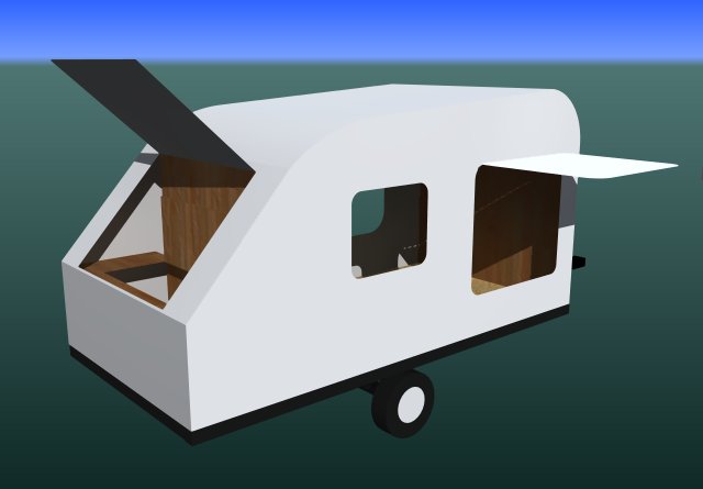

and my design as it stands prior to cutting any wood

Postby Juneaudave » Sat Mar 06, 2010 12:41 pm
Ok...nice design, where does the wine rack fit? :lol:

Postby pete42 » Thu Mar 18, 2010 10:46 pm
Ok I have google's sketchup 7 but my drawings don't look like yours I guess I need to practice .
looks like a good plan.

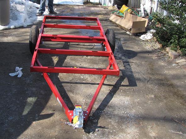

Postby parnold » Fri Mar 19, 2010 7:23 pm
Ok.. the promised pics.. more and better tomorrow if all goes well.
Here is the completed frame from two weeks ago.. note the snow.

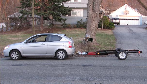

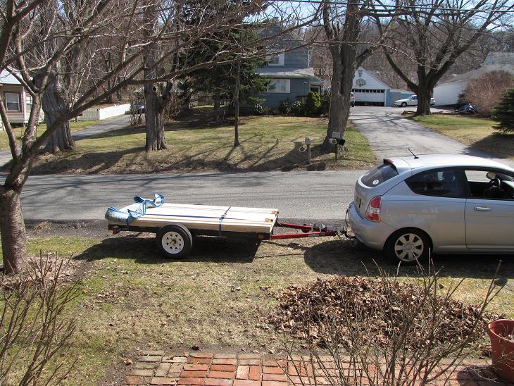

And here is the trailer hooked up to my car after it's maiden voyage, all ready to go get lumber tomorrow morning!
The weather is supposed to be perfect tomorrow, 71 degrees and sunny. My goal is to get the floor together, and undercoated, and if I'm lucky to get the walls cut to form and start sanding them. I am not insulating the walls, they will be 3/4 ply with structural support added for windows and doors. I don't plan on camping in the cold and I want this to be a quick build. My second will be an all out build that I can take my time on.

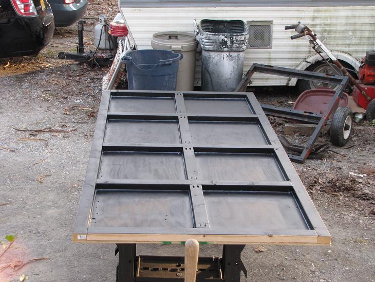

Postby parnold » Sat Mar 20, 2010 7:02 pm
Home from the big box store...
and then there was sawdust!!!!!

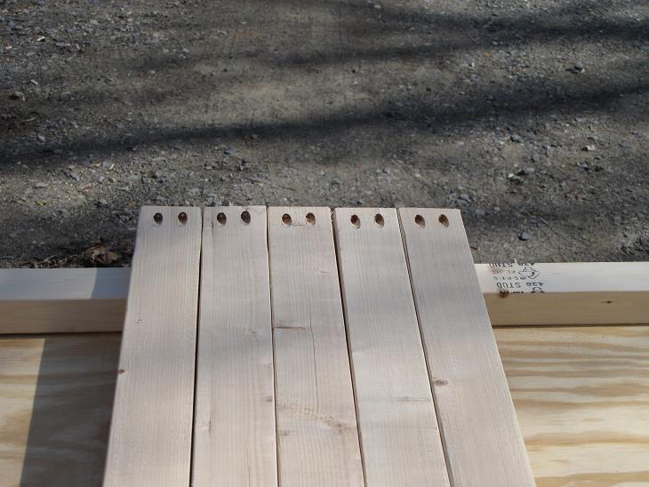

got a new toy today.. pocket drill thing.. pretty cool

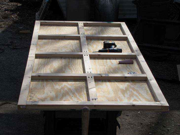

glued and screwed!
and finally, undercoated, and seams sealed with silicone.

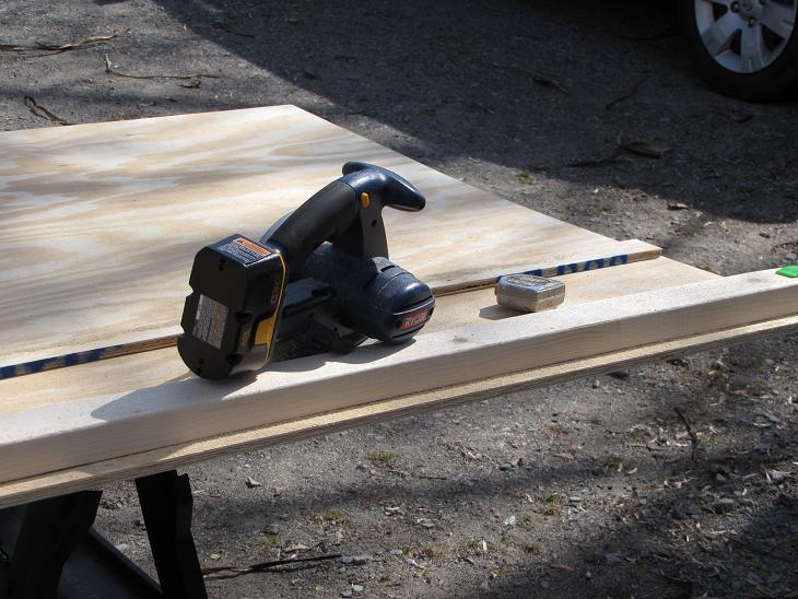

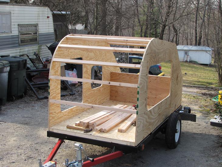

Postby parnold » Sun Mar 21, 2010 4:06 pm
Well today was extremely productive, started the saw up at 9am.

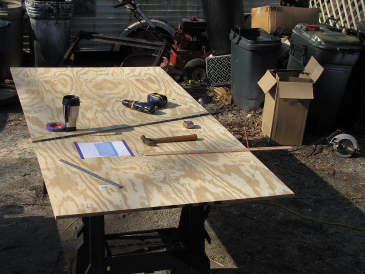

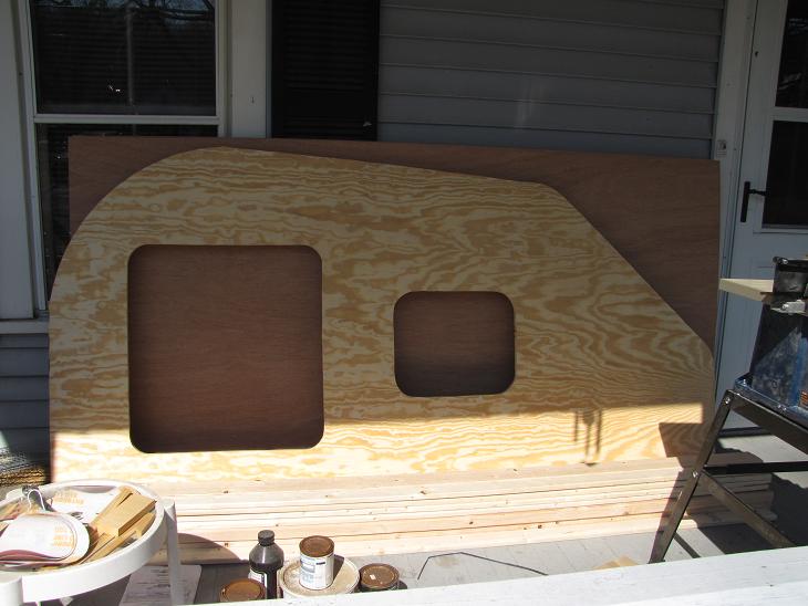

Here you see my 65 cent home depot yardstick used as a compass to mark out the curves.
After I cut the first wall, I laid the door and window on top to trace the openings.
And... the holes are cut.

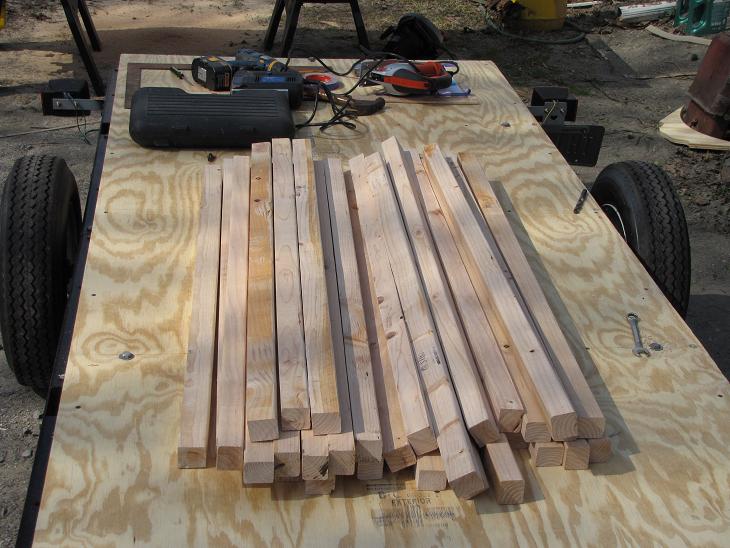

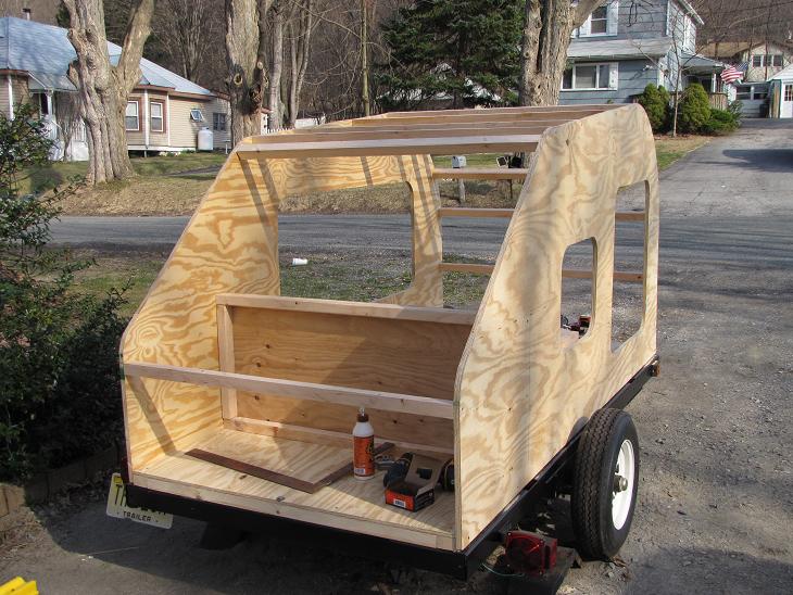

The 2x2's at the store we horrible, I ripped this entire pile from 2x4's.
With my son's help I got a lot of the roof spars installed.
And another angle....
From the back....
And finally all wrapped up.

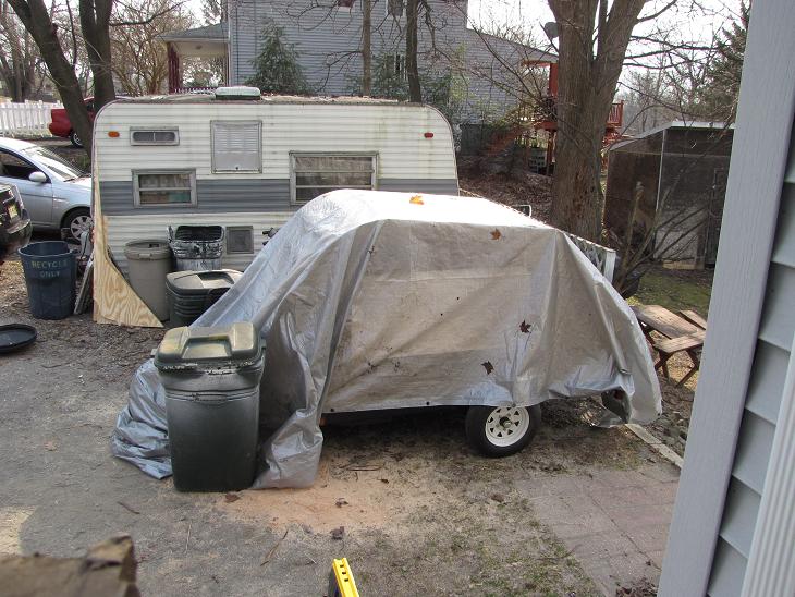

It's supposed to rain the next couple days. I have Wed, Thurs, and Friday off this week... so more to come.
