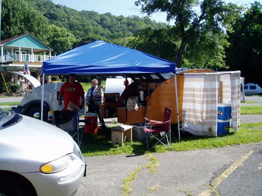

cuyeda wrote:KISS! This is Gage and Tanya's rig. Two extended tent poles, C channel on the roof line, perhaps some velcro straps to wrap around the poles to keep it from flapping around. Hard to beat the classic designs.
If you don't already have the C channel built in from the start, I am sure a little creativity with some D rings, or some type of hooks can be added to the roof to anchor the awning.
