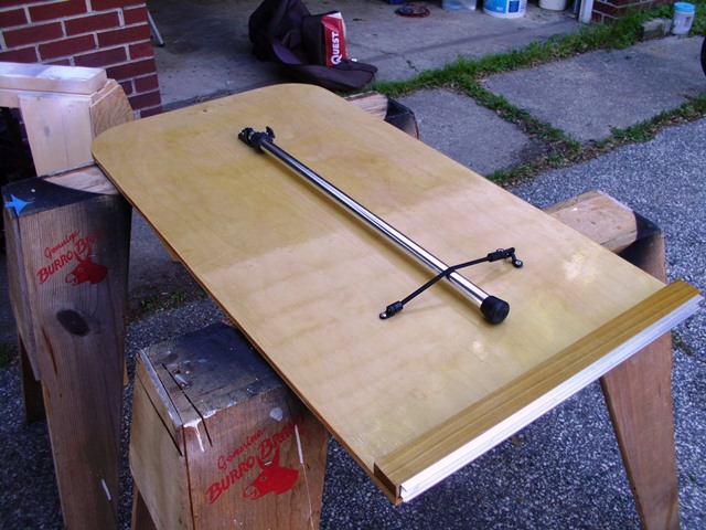

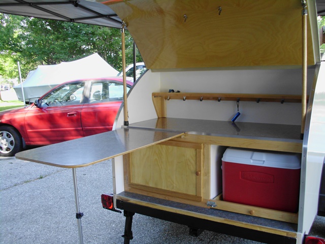

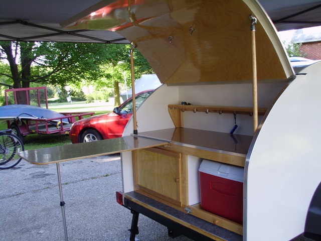

You can still use an extension table without having it attach to the side of your teardrop. Just have it extend off of your galley counter. The bracket/leg kit is very reasonable (about $25 if I remember correctly.) It's very simple to do. I just store mine laying on my galley counter. Will probably put a sheet of non-slip rubber shelf liner under it in transit. I covered mine with the same Formica that is on my counter and it looks very nice.

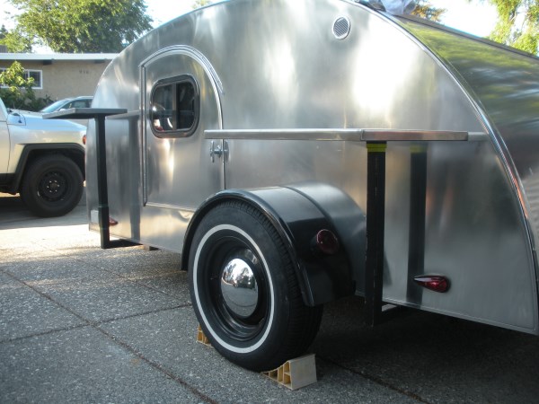

This is what we have done with receivers mounted at the front and back of the trailer. This makes it easy to move the tables around depending on the terrain. There are more pictures in my gallery. Hope this helps you out.
