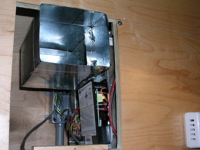

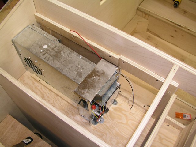

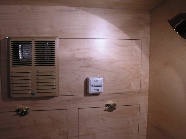

Here's the forced air furnace in my teardrop...
I can't see how I can do that with the Nu Way propane stove.

Postby KCStudly » Tue Nov 26, 2013 8:30 am
That sure looks like the best solution for some one who plans on camping in cold weather on a regular basis.
Nice and new, too. How does it compare on cost?
