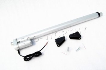

Brian, I've narrowed it down to one of these two:
Aluminum folding telescoping legs @ $28 each. They have a weight rating of 200lbs each. These would be mounted under the slide.
Or these 12 volt linear actuators @ $65 each (kinda spendy for a budget build). They have a weight rating of 330lbs each. I would mount these in the rear inside corners of the slide with separate switches for uneven ground.
