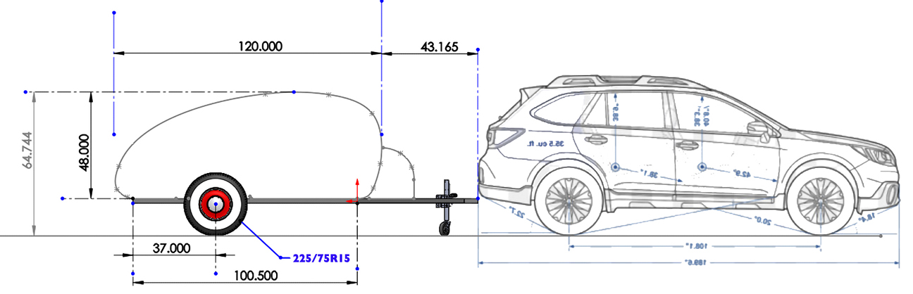

Postby Capebuild » Sun Feb 14, 2021 10:27 am
Thank you all, once again.
I did a quick rendering of what a 10 foot trailer might look like. Now that I see it, doesn't seem so bad (or scary). We do not plan on having a sink in the galley so the will cut out a few things (sink, pump, grey water holding tank). As I continue to create files for the design I can get a rough ball park of weight.
I think I'll change my plan and start with a 10 foot design. I can then reduce it if it starts to look heavy (or scary) :o
regards
John

Re: Cabin Length-Questioning Size
Postby tony.latham » Sun Feb 14, 2021 11:15 am
That's a pleasing profile. :thumbsup:
