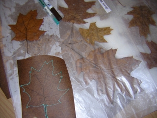

I stained some of the Kraft paper close to the color of the freshly gathered, unfaded leaves:
Using a brightly colored gel pen, I copied the outline of each leaf onto the stained paper, drew in the veins, and cut them out. To ensure that the colors wouldn’t run, I sprayed each “leaf” with varnish.

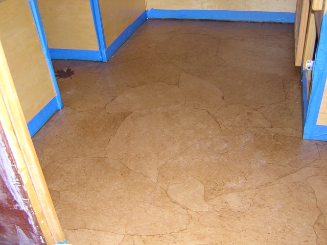

Then, I set about laying the basic brown paper floor. Here is a picture of part of that, without leaves:

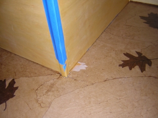

After that was dry, I pulled off the blue painter’s tape and :Oh Brother: pulled too much:
Image (I scored the rest of the way with a knife before pulling any more tape!)
That little Oops! was easily fixed with a “damaged leaf”. Mother Nature isn’t perfect and neither am I. :lol:

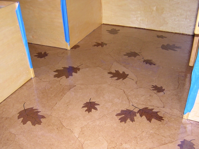

After the leaves had dried in place, I began ‘topping’ the floor with more layers of Minwax Polyurethane. Here, you see it with the second coat freshly applied:
…Two coats down and four more to go! Then, I’m supposed to wait 3 days before ‘using’ it and 7 days before walking on it. But, there are lots of other things to do while I wait….

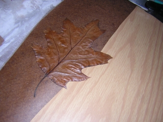

I collected the leaves but elected to use hand-made copies of the actual leaves for a couple reasons: 1) any dampness still in the leaves could be problematic once encased in polyurethane and, most importantly, 2) since mine is a walked-on surface, the weight of people might eventually pulverize actual leaves. Your leaves will look great on a tabletop!
