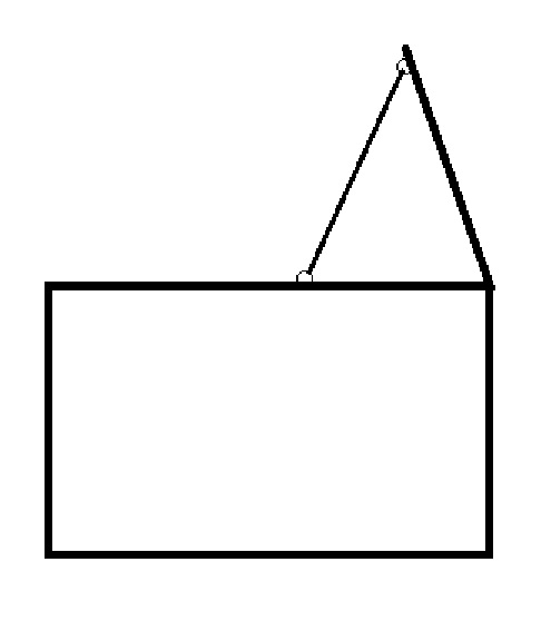

Postby Evan Gaffney » Mon May 07, 2012 1:22 pm
Why not put two eye hooks into the roof and two into the hatch then make two poles of fixed length with caribiner-like ends? Should hold your lid up at any angle you decide on and stop it from blowing/falling in either direction. You could even put some "upside down" cabinets onto the inside face of your hatch.
Something like this:
