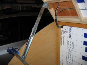

Postby Dean_A » Tue Jul 08, 2008 4:16 pm
Heikki,
Sorry to hear things aren't going well. For what it's worth, I had a devil of a time figuring out my hatch support locations as well. I ended up going with star wheel type supports. It took one variable out of the equation (lift capacity), and that was enough so that I could wrap my brain around it.
I'd take another look at Craig's post above. i don't pretend to understand it all, but the man seems to know what he's talking about. 8)
Here are my hatch supports:

Postby Classic Finn » Tue Jul 08, 2008 4:22 pm
Dean Im almost ready to get a couple of grandmas Broom Handles and say we,ll just keep it simple. I must be illiterate or somthing..
Ive looked at them photos and reread all of the above for hours this evening and I even printed things out.
Yours look plenty strong there Dean. The thing is we had our shocks also to the position you have.. and nuttn.

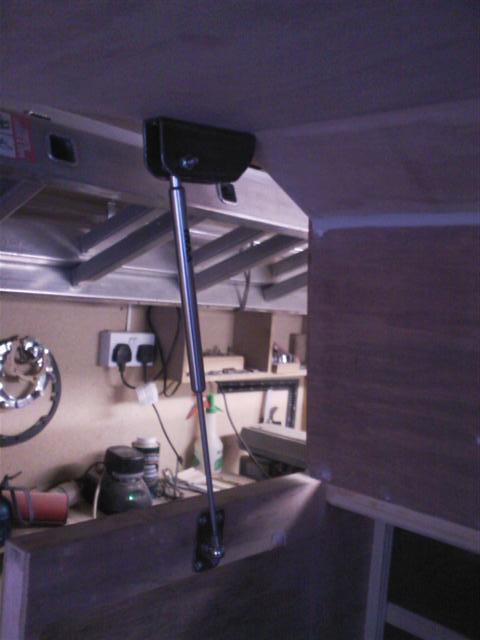

Postby Classic Finn » Tue Jul 08, 2008 4:38 pm
Heres a couple of more pics as to how we had them as well.

Postby tonyj » Tue Jul 08, 2008 4:53 pm
First, the alignment issue. Using the brackets you have, the top bracket will have to be flipped 180 degrees with the narrow end with the ball facing down. With the ball facing down, you will also have to flip it so the ball is facing the closest wall of the tear, not the opposite wall.
Place that top bracket about 6 inches from the hinge (close to where you had it in the first picture. With bottom bracket unscrewed from the wall, (at this point, the top bracket is attacked to the hatch rib, the strut is attached to the top bracket and the bottom bracket is attached to the strut but not screwed to the wall), raise the hatch to about an inch higher than the maximum opening you want. (Make sure the bottom edge of the hatch is high enough so you don't hit your forehead on the corner of the opened hatch.) Prop the hatch open at this height with a board or stick or whatever makes the proper height. Now screw the lower hatch bracket to the wall down from the edge the distance of your hatch rib plus a quarter to a half inch for additional clearance.
If your fully opened strut is vertical like in one of your last pictures, the hatch won't close. It has to be at an angle.

Postby Classic Finn » Tue Jul 08, 2008 5:00 pm
So Tony these shocks arent too short ?
at 10 inches closed and 20 open?

Postby QuietOutdoorsman » Tue Jul 08, 2008 5:05 pm
Finn,
I hate to break this to you, but I think you need new struts. :(
Just looking at the pictures of your design, the 10 inch stroke of the current struts will force you to mount them pretty close to the hinge. But that would drive you to a higher load capability than those struts have.
So....longer struts with the same load rating, or stronger struts of the same length.
If I knew the exact dimensions, weight and position of center of gravity of your hatch I could help work out what you would need.
