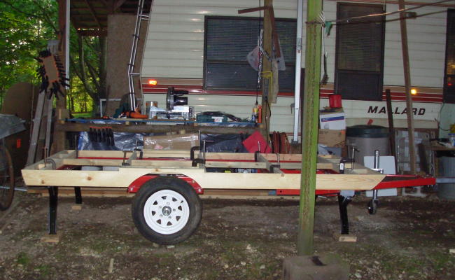

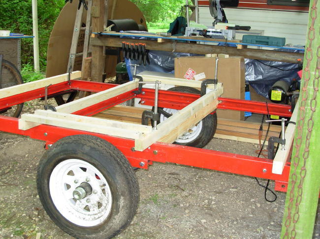

Postby Ron Dickey » Wed Jun 20, 2012 12:21 am
I used Kill dried 2x4's reduce weight and will not worp.
173882......173887

Since I was using the 1740# 4X8' HF trailer w/12" wheels/tires, & wanted a 5' wide TD, it meant the cabin would extend over the tires on each side. It was therefore necessary to devise a way to incorporate 'wheelwells' without intruding too high into the cabin space. After careful measurement I decided that 2x6's (approx 2 5/8") ripped in half would provide the needed space for wheel/tire clearance & only intrude an inch or so into the cabin. I also wanted to 'hide' the trailer chassis so I used 1x6 boards as side rails for the floor assembly, with the excess width 'hanging' below the floor. Couldn't find/afford a piece of 5x10' half inch plywood for the floor so I 'pieced' it together from 2 sheets of A/C exterior grade ply. After completing the floor I turned it upside down, coated with asphalt roofing 'goo' & then insulated with 1" foam 'Dow Blueboard' placed in the framing recesses. Used construction adhesive on the foam & then stapled 'battens' from scrap to hold the foam in place before fastening to the trailer chassis with eight 3/8" carriage bolts. For 6yrs & more'n 12K miles the insulation has stayed in place & there is minimal damage/marks from road debris to the exposed foam.
The extra 'thickness' of the floor assembly also provided 'holding' material for fastening the walls in place. My walls are sandwich construction, built from inside out, flat on a table. After staining/varnishing the 1/4" oak plywood interior skin & adding 1x2' framework, walls were erected onto the floor, held in place with braces/clamps, & then fastened directly to the floor using construction grade deck screws & PL5200 adhesive. Walls were then insulated, skinned with 5mm luan, roof spars/insulation/luan added, followed by aluminum skin & diamond tread trim.
I'm sure there are other ways, probably stronger, lighter, & maybe easier to build but this was my way & during Labor Day weekend 2010, the TD cabin withstood with minimal damage a rear end collision that caused considerable bending/twisting of the rear cross member & left side reail of the HF trailer chassis.
Oh yeah, after all my careful measurement/calculations, after a few thousand miles over some pretty rough roads I found that the tires would occasionally contact the bottom of the wheel wells so I added a 1" steel spacer between the axle spring seat & the springs, eliminating that minor problem...
