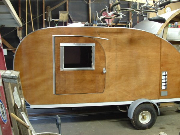

I just picked up a chrome louvered vent exactly like what I was looking for from Keith a member here. Here is his teardrop and a pic of a vent like what I got:
Another big bonus was to get to see my first homebuilt teardrop today! I was very excited about that and it was good to meet you too Keith, we live very close to each other so that is cool too. It was good to see that project because it is so similar to the one I am doing.
