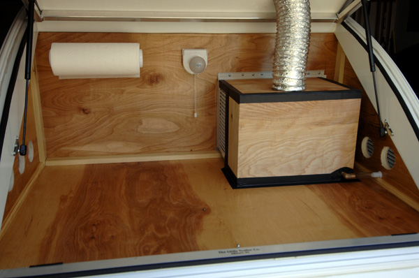

I bought my Little Guy without a galley (mine is a 4-wide).
If I were to buy a LG 6-wide, the first thing I would do is take out the galley, and build a new one. The problems you described are the reasons why I would do that.
LG makes a nice TD, overall, but the galleys are the weak link in the chain. They are not well designed, and not built as well as the rest of the TD.
I started with just a simple galley enclosure made with the same Birch plywood as LG uses on the side walls...

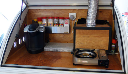

Later, I added air-conditioning to my TD which ate up some galley space, but works well here in Texas. If you can do without AC where you live and camp, you'll have a lot more room for galley stuff.

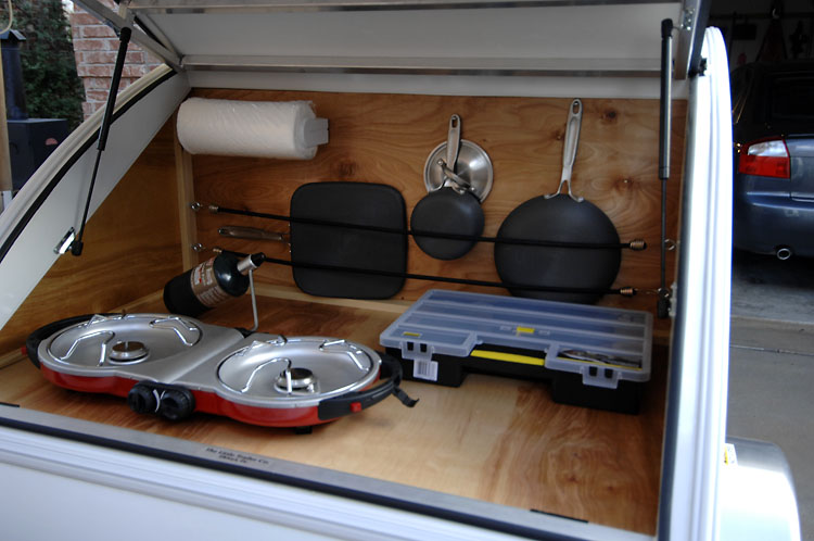

Then came a side table...

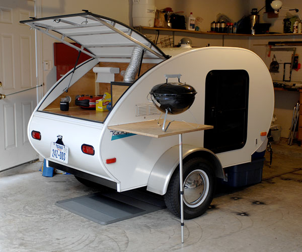

Then a bigger side table and a good stove...
I'm pretty happy with it they way it is now. But, who knows what I might do next.

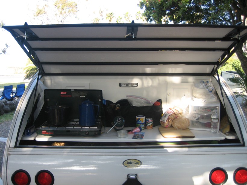

Postby mikeschn » Sun Jun 08, 2008 1:31 pm
I'll bet there's a lot you could do with that... but here, let me post your picture to get the ideas going...

Postby caseydog » Sun Jun 08, 2008 1:43 pm
fireaunt wrote:I like Mike's renovation alot! Especially if you do short camping - you can just open it up and you are ready to cook. :thumbsup:
Marilyn
The Picture Mike put up is of the stock LG galley. Notice how the countertop bows down in the middle. And, there is a gap for food to fall down and beverages to spill though (and critters to get through) between the countertop and the back of the TD.
