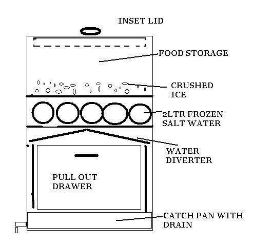

Postby bobhenry » Thu Apr 07, 2011 11:47 am
The link to the older icebox thread led into the concept of using frozen salt water to drop the temps in the unit.
A little looking around led to finding frozen salt water can drop the freeze point up to 40 degrees. Figures I saw gave a 23% salt water mix by mass a -5 F freezing point. I am no thermodynamics engineer and an not interested in debating the math but it did set me a thinkin'
Here is what I came up with........
The shelves you see above and below the 2 liter pop bottles of frozen salt water are perforated or perhaps a close wire rack. The inset lid on top is removed and the top shelf is also removed. Place the frozen bottles in place tightly replace the shelf and deposit the crushed ice. Then the food stuffs that are more frequently accessed and are more water tolerant are placed in the bed of ice. While the colder salt water filled bottles will greatly extend the life of the store bought ice it will eventually melt. It will then drips down to the diverter and is funneled down the side close to the super insulated outside walls and deposited into the catch pan where it will give up the last of its cool. A drain is shown but a higher mounted overflow with a trap may be a better option to avoid overflow. The back wall of the front drawer when pulled full out for access should close off the icebox to eliminate the escape of the cold air.
OK what did I miss ?
and does this look to be a viable design ?
