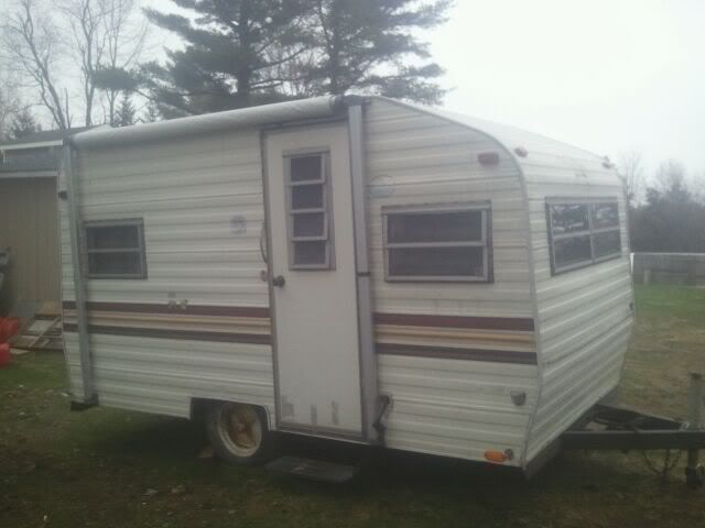

First an update: By sometime today my baby should have been towed over to my friend's yard by the former owner. She is away for the weekend but when she gets back she will tow it across the street to the RV place so they can replace the tires/wheels and bearings. Not sure why we didn't just have the owner tow it right to the RV place??? But that was the arrangements made on my behalf. I've spoken with the RV place and Dave will go over the trailer thoroughly to make sure there are no surprises. I'll be in contact with him after the looksie. I've also contacted my ins. co and have the RMV1 form to bring to the RMV next week so I have plates to bring up with me. So, here are my questions:
1. I've spoken with my mechanic and I'll be bringing my Outback to them on Thursday to have the tow package and antisway bar installed. He said he can only install the antisway bar if the frame is an A frame construction. Aren't they all Aframes? Anyway, I sent him pics and the video my friend took by sticking her phone under the frame. He said it looked like an A frame to him.
2. What happens if I get the swaybar installed and it turns out it's NOT an Aframe trailer?
3. He's putting the heavy duty tow package on - the 3500 lb one. I was reading on some website that everyone should have the 5000lb tow package. Is this true?
4. Mechanic spoke with Subaru dealer about the extra trannie cooling system I had requested be installed and dealer said I don't need it fo the weight I will be towing (dry=1480lb). He said the cooling system in these Outbacks is pretty heavy duty and as long as I'm not traversing mountain ranges I should be OK. I'm only planning to travel around New England at this point.
5. We decided not to go with trailer brakes as I'm well below the MA limit of 2000lbs. Should I pray everytime I tow this thing? Should I save up my money and eventually get brakes installed?
6. The specs from Play-Mor says that the ball is a 2" ball but the owner quite clearly told me its got a 1 7/8 " ball on it so that's what we're putting on for a receiver. Is it typical for the factory installed ball to be switched out for a smaller one? I just hope I'm telling my mech. the right size!
7. This rig does not have heat as far as I know and definitely doesn't have AC. Is AC very expensive to install? Should I splurge on a portable unit from HD for now or would it be about the same $$ (300) to have the RV place install a rooftop unit?
8. If I stow about 50 lbs of xpens and an easy up plus lounge chairs in the closet that is on one side of the trailer, is that a significant enough amount of weight that I'll unbalance the trailer during towing? Should I be stowing these things on the floor instead?
9. Do all trailers come with a battery? If this one doesn't, what kind should I get? Do I need to keep the fridge cold during travel (well I guess the answer is yes if I don't want food to spoil!!)? I guess what I mean is do most people with a fridge keep it on during travel or is it just something you turn on when you hook up to shore power and you keep food in coolers other times? There may be a number of agility trials I go to where they allow campers but there are no hookups at all. Not sure how to prepare for this type of camping? do I need a generator and isn't that going to significantly increase my tow weight?
10. Any other words of advice or tips for this newbie?
I guess if I go into foreclosure after all this I can live in my camper!! $>

As far as brakes go, if you are towing a 1,400 lb trailer with something as small (albeit mighty) as an Outback, I would get brakes.
I assume by A Frame, they mean the tongue of the trailer is an A, rather than a straight tube. Mine is a straight tube.
This is an A Tongue.
I have never towed with an anti-sway setup, so I don't know how they affect towing.
If the ball size is wrong, it is easy and inexpensive to correct on the tow vehicle side. Have Dave check this for you.
Have you checked the electrical connection? Some are 4 wire, some 6, and some 7. There are adapters if your TV is 6 or 7 and the trailer is 4.

Looks like a perfect happy little trailer in great shape! Looks like it may even have a hardwood floor.

Postby Engineer Guy » Sun May 08, 2011 1:01 am
I snagged an '89 [or '88?] Play-Mor M 1500 a few months ago, and am about to take it out. Here's some thoughts. See Album TT pix linked below to understand some of my assumptions.
1. Your pic indicates it's an A Frame, as seen from the Trailer Ball Coupler going back to the TT 'Box'. >1/2 way back on each of those A Frames is where Sway Bars connect; that's likely the basis for your Mechanic's statement re: needing an A Frame config. I don't have them installed; no need.
2. A non-event, given the Cellphone pic supplied.
3. The option of a 5,000 lb. Towing Package is not applicable, and would be money-wasting overkill. See Outback Towing capacities linked below. If this Website info is off by a hundred lbs. or so, that's 'in the noise' and of no importance. Go only for the 3,500 lb. package at most.
4. You could first try a tow w/o the Tranny Cooler. My Montero Sport is good for 5,000 lbs Towing conservatively, and has overheated the Tranny at >9,000 [thinner Air] in Summer w/the AC on w/towing a Popup Tent Trailer. Only one way to find out; try it. If you 'burn' the Tranny Fluid from excess heat - you'll smell it and perhaps even see it smoking - and the darkened Fluid and Filter will have to be changed out after you limp home w/AC off. I'm not trying to be dramatic; that's sort of what winds up happening. You want to pull over and leave the Engine running to cycle and cool the Tranny Fluid. The full story is that my Tranny Pan was 'undersized'. A larger one was installed by the Dealer @ n/c to quietly 'fess up to the atypical Factory design mistake.
Rather than the likely-present 'Idiot Light', you could likely do a little homework and install a 'real' AT Temp Gauge down the line to first monitor Tranny temps. With 'Real World' Camping gear stowed, you'll be close to the Outback Tow Specs below.
5. In the latest go-round here, I weighed in on the 'gotta have Brakes' side. It's about control on curves, etc., to me, since hitting the Brakes on curves [not tracking in a straight line] to avoid a Deer at dusk is Real Life as I know it. At the very least, stopping distance will be longer w/o TT Brakes. To add them, the Manf. and Model of the Axle must be known, typically, and whether there's a Backing Plate on already for the Brakes to bolt to must be confirmed via pix. My $0.02: put your Moola towards TT Brakes. You can fatigue Tow Vehicle [TV] Brakes on curves, and face Mr. Murphy and his Law RIGHT when you need full stopping power. Rock in the Road, etc..
6. In the casual World of 'Standards', that dry weight of TT could merit a 1 7/8" Ball or a 2" Ball. Do a dry fit to a Ball [even if unmounted] and confirm what you need. My heavier M 1500 has a 2" TT Factory-installed Coupler [female 'Ball' end]. The Owner might have USED a 1 7/8" Ball; that wouldn't be the first time. You don't want slop or a misfit, but this is very easily confirmed with a quickie dry fit experiment. The Ball diameter size is sometimes stamped on the TT Coupler.
7. A Furnace and Factory-installed Fridge have external, openable Doors, and exterior Vents. I see none in your Cellphone pix. I see no A/C. The 30 Amp Plug/Cable is just right of the Entry Door. The fresh Water fill is further toward the front end of the Box on that same Passenger side. As with mine, your Fresh Water Tank and 115 VAC -> 12 VDC Power Supply is either under the Dinette Seat, or under the Couch [where my Tank is]. Visually chase those down for confirmation by lifting Cushions and Wood Panels

Postby dmb90260 » Sun May 08, 2011 1:08 pm
I have seen a lot of vintage trailers and few have a/c units hanging out a window. The windows were not made to carry that load and constant shaking when driving can lead to leaks around the window. One solution I have seen is mounting the unit on a slide so it travels inside the trailer and is put out when on site. Others have been installed in the space below the back bed and a couple have been "built-in" closets or cabinets. Those will require some kind of venting, the a/c does generate a lot of heat.
I have a couple small portable fans and a Fantastic fan in the ceiling. If it looks like the place I am going will be extra hot, I do have one of the small a/c units which I will place in the doorway, mainly for my dogs. I just get another big tonic. :icedtea:
