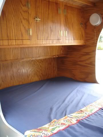

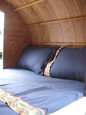

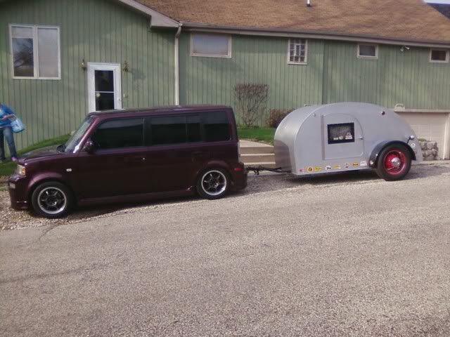

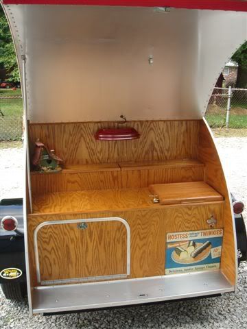

I have a teardrop based on a 47 KIT. I am looking for a side room/tent to give us a bit more room, a place to change clothes and possibly get out of the rain and/or bugs.
I have seen the one offered by Camp Inn (http://tinycamper.com/tent.htm) $297 - nice but a bit small . . . and pricey.
. . . and the one by Little Guy (http://www.golittleguy.com/teardrops/tr ... ptions.php) $595 - really like this one, but the price is outrageous!
. . . but was looking for other, lost costly options. Any ideas?
Pics of our teardrop for good measure . . .

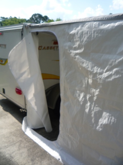

I have a taller teardrop style trailer and mine has an awning. I purchased a good quality white tarp and a door kit and fashioned a vestibule for my trailer. The whole cost was under $75.00 and accomplishes the job very well.

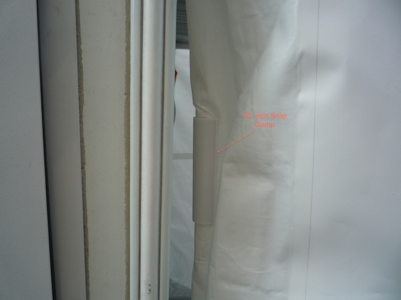

The frame is the awning support legs and top and then I also use these to attach to the sides of the trailer,
They allow the tarp to snap into the Snap clamp using 1/2 pvc pipe and then I am working on securing the snaps to the trailer using snap buttons. I will take a better picture once is completed. This setup gives me a 6 x6x 7 feet vestibule that is rain resistant and I can also add windows if I want.
