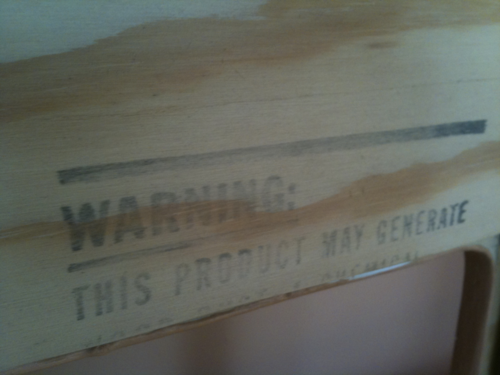

Postby kinto » Wed Aug 31, 2011 9:04 am
luckily for me i didn't cut my plywood in california! :o :lol:
(sorry, i know that was a hacky joke...)
