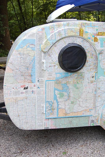

""also was wondering how to add color. i would like to make the floor with different colors (if possible). any ideas on this?""
How about the sunday comics..... :laughter:
One of the trailers at the Crossroads of America gathering last summer had a giant wall map sealed on the exterior of his trailer. Might be a great way to never get lost :roll:

so could you use old nautical maps for this or would it not work
