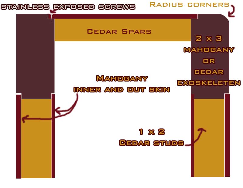

Build an exoskeletin out of cedar or mahogany, dado in the ply skins, embeding them in gorilla glu or epoxy
Once sealed, all endgrains would be embedded.
Use stainless or brass exposed screws, or copper nails spaced for appearance, Put a radii on the outside corners of the exoskeletin. epoxy, glass or poly the exterior
Vintage aluminum windows and doors and stainless piano hinges
or make own window frames out of mahogany
Bottom paint lower 10 inches nice marine red, with a white breaking stripe
Couple nice stainless deck vents
Deck plates for cable hatches
Theres 100 year old mahogany boats out there, should last forever
