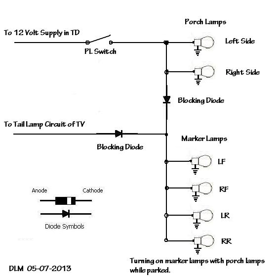

Absolute easiest way to make driving markers come on with porch lights would be to just add wiring from 12 volt source inside trailer that powers porch lights and control them from porch light switch.... However you may (will) need BLOCKING (isolation) diodes so porch lights are not on when in tow mode (clearance lights only for trailer) or so you do not feed back to TV with power from trailer to TV lights while parked but still connected.....
http://www.the12volt.com/diodes/diodes.asp
Porch-marker lamps.JPG (28.91 KiB) Viewed 932 times
Dale

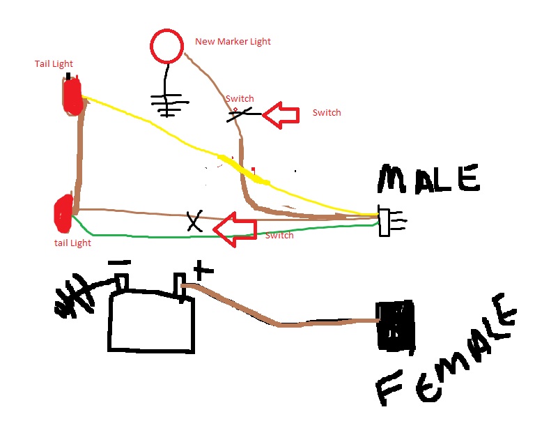

You are 1/2 way there. If you take the charge wire you have now, and connect it to a copy of the tow connector on the back of your car, you just plug the Tear drop ( male) end into the female connector that gets power from the tear drop battery once you park. The switches are so that you can turn off the marker lights during the day or what not.
Here is a very poorly drawn schematic assuming you are using the "flat four" connector.
td klights.jpg (64.48 KiB) Viewed 926 times

Postby burlesot » Tue May 07, 2013 9:19 pm
Dale,
I'm not familiar at all with a blocking diode.
Can you put that in layman's terms?
I really appreciate all of the posts trying to help.
I especially appreciate your patience with my ignorance.
Someone quite wise reminded me that we all are learning.
T
burlesot
Posts: 280
Images: 62
Joined: Mon Jul 16, 2012 3:10 pm
Re: Marker Lights; how to make them 'switchable?'
Postby jss06 » Tue May 07, 2013 9:32 pm
burlesot wrote:Dale,
T
The blocking diode allows electricity to flow only in one direction. In this case it is the direction the arrow is pointing and stops electricity from flowing through the porch lights except when the light switch is on. In the diagram, think of the diode as a one way valve. As long as electricity is flowing in the direction the arrow is pointing, the ciruit works like a copper wire. If electricity tries to go in the opposite direction, the diode acts just like a wall to keep it from going that way.
