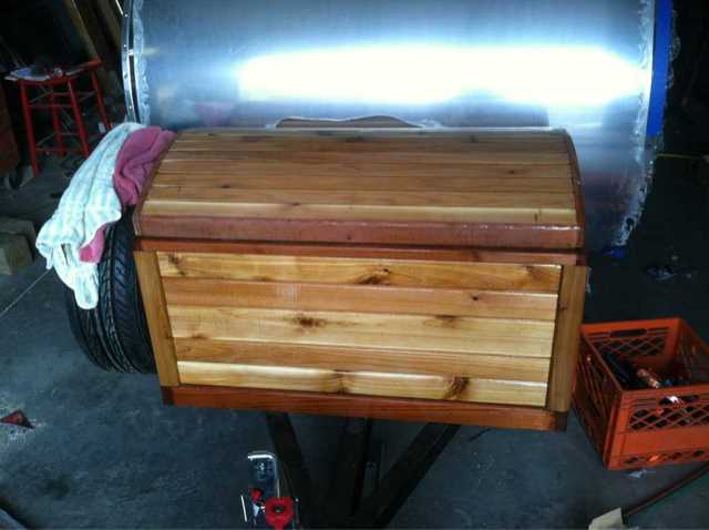

There are many with A/C units mounted in the galley, but as far as I know, mine is the only one to be designed to run with the vertical hatch closed, venting to the side and away from the trailer. I think there may be another, which vents the exhaust down and out below the trailer, but I can't find it now. Anyway, to do it again, I'd still want it in the galley (mine is a storage area, not kitchen...full of combustibles more sensitive than mere butter), able to run at night with the hatch locked. But, I'd vent it straight back, not to the side, with a louvered hatch within the main hatch, to allow exhaust out, but keep prying hands off my gear. Here are some photos:

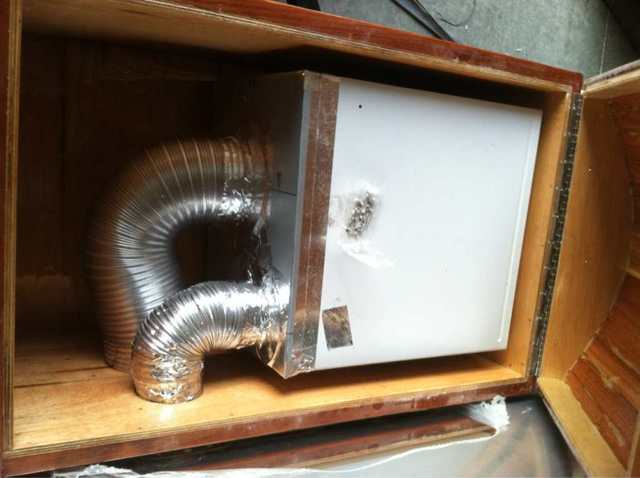

Here is mine

Postby kd5edj63 » Mon Oct 14, 2013 9:22 am
I'm confused by the multiple ducting. Wouldnt it suffice to run just one hose that blows the cool air.
Edit. I take it the radiator looking thing in the front lower section is whats called the evaporator and air must pass through that to remove humidity. Is that correct
kd5edj63
Posts: 130
Joined: Fri Oct 04, 2013 3:17 pm
Re: Air conditioner mounting ideas
Postby aggie79 » Mon Oct 14, 2013 9:43 am
kd5edj63 wrote:I'm confused by the multiple ducting. Wouldnt it suffice to run just one hose that blows the cool air.
A window unit has two air "loops". One loop is to cool the compressor. Typically the intake for this loop is on the side of the A/C and the heated exhaust air is at the rear of the A/C.
The other loop is for the conditioned/cooled air. There is an intake (supply) side which can be either make-up air (fresh air from the outside) or return air (conditioned/cooled air that has been partially warmed and is recirculated back through the A/C). In the installation above one duct is for supply air (the cold side) and one side is for return air. By recirculating the air, the A/C will remove more moisture/humidity from the air than if it the supply air was from the outside and the A/C compressor will not cycle on and off as much. This is how I have our A/C setup. Of course, with the teardrop being air tight (Or pretty much air tight), we leave either the vent of a window cracked so that we don't die of CO poisoning.
