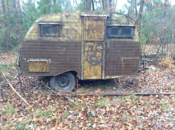

Hey guys and gals, I am about to pick up a '67 Scotty Sportsman that is a rebuild and all of the windows and gaping holes are filled with the foam wonder named Great Stuff. I want to rid my self of this parasite. Once I remove the trim, windows and door and complete my razor blade removal treatment, how can I get the rest of the little stuff off? I humbly bow in acceptance of the ugliest camper award! LOL

It atually has a screen door too! Although they Great Stuffed it to the cabin door, I guess to keep it out of the way LOL... the door and storage compartment look like OSB in the photo, but it is just the paint it is actually the original door with the Bargman handle (Broken handle but possibly repairable).
I think I will avoid the fire idea but it's an interesting thought. With aluminum being so fragile I would be afraid of it melting. If the scrape and wipe with multiple choices doesn't work, I'll look toward sandblasting. If I do that I'll probably do all the walls completely bare. Even if it is dinged up, I would like the bare alumimnum even oxidised.
