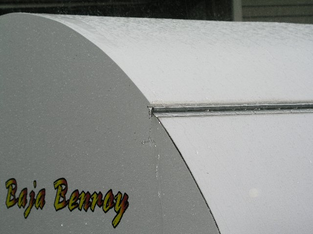

Every thing went well, except, the hatch hinge leaks when it's open. Water ran down the roof and seeped through the hinge. I put a tarp under the e-z-up and over the roof, the seeping stopped. Is this a typical occurrance?

I didn't eyeball your hinge close enough in CT. Is it one of Grant's Hurricane hinges? If yes, does it extend beyond the edge a little bit?
Unless I put a tarp over mine, I expect the water to run down the back to the hinge, and the hinge to drain it over the side, as such...

I'm not sure how our hinge would work in the rain with the hatch up. It's Grant's hinge..but we cut it the size of the galley hatch...bad move.

The hinge is Grant's. I cut it so that it sits proud of the wall /roof line about 1/2". The hatch is fine when down, I suspect that it may be a problem with the way I set up my E-Z-Up. The rain poured off the tarp, right on the lid, then thrugh the hinge.
See the second photo above.

Yep, I suspect you're right. Just move the easy-up forward about 6 inches and the rain'll be dripping on the correct side of the roof!
