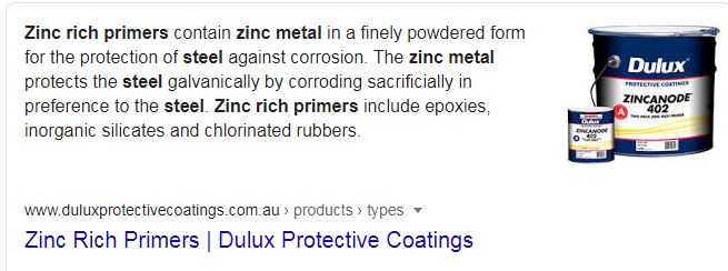

It might actually be better to drill a couple of drain holes in each frame member and leave them open.
If your frame is not made from galvanised steel, use zinc rich primer.
Over here, we can get several primers that contain rather a lot of powdered zinc metal.
I'm talking primers that give you a surprise when you pick up a litre can and feel the weight.
zinc primer.JPG (43.95 KiB) Viewed 1746 times
The zinc is there as the metal, not some compound.
They provide galvanic protection in a similar way to hot dipped galvanising.
The thing about electrically (galvanically?) connecting zinc to steel is that it provides some protection remotely.
The other thing you can do is get some anodes from an outboard motor (the ones meant for seawater, not fresh water) and bolt them on. I have found this worthwhile on a boat trailer that was getting old and had lost most of its sacrificial zinc coating, buit not so effective on a land trailer.

I am not a great welder, thats why I will be putting seam sealer on the welds. I know about fluid film, that would be the retreat item in a few years. I did think about tek screws, but tek screws like to drill thru one metal in to another layer to hold they dont like to hold single layers of thin metal well.
I have used the zinc rich paint before on a water tower, 50lbs of zinc, 10 lbs of epoxy paint in a 5 gallon can. Boat zincs need to be wet to work, preferably with salt water, that why they dont work that well in fresh water. They make Magnesium one for fresh water.
I have thought about just drilling drain holes, but with out truly being able to coat the inside of the frame with a rust preventive, I know the metal would rust and I could not see or do anything about it. If I could get it galvanized for a few hundred bucks I would but I assume its much more expensive than that.
Sarcasm time. Maybe I will just hook up an argon tank from my welder and purge the frame non stop.
