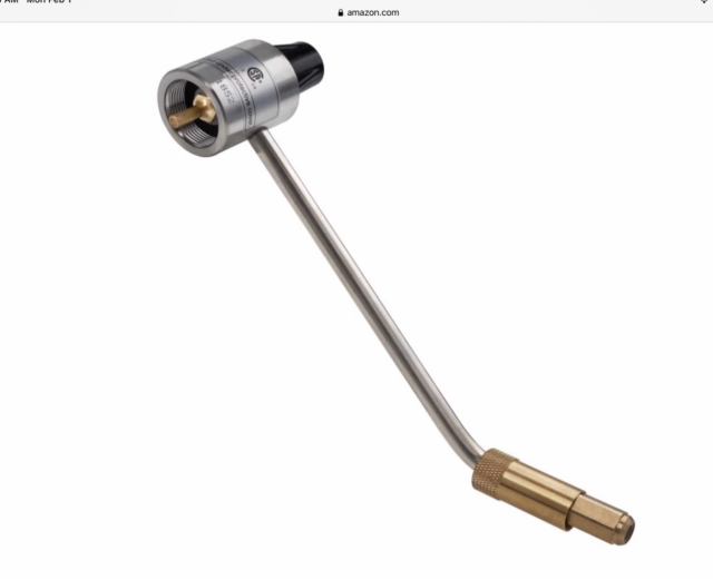

I have at least 6 different Coleman stoves in the garage, some propane and some white gas models. The only one I really like is the cheap 2 burner propane model. I like the convenience of the small disposable propane bottles and the uniform heat from the two burners when using a double griddle (something the white gas models don't do very well). What I really hate, is that it utilizes one of these things:
This stove to bottle connection is clumsy and always has the bottle on the table surface right beside the stove. I've tried a hose running from the connector to a bottle on the ground, but, its still clumsy because of the need to have that hated connector on the table top. Does anyone have any thoughts on how to safely eliminate this with different parts, or perhaps safely modify it some way?

There are adapters all over the web, eBay Amazon etc.
Coleman 1# bottle connection is commonly referred to that way,
also 1"-20
female on the bottle side, male toward that stove connection
semi-flexible copper pipe with flared connections
will be safer, last longer than flex hose with barbs - leak test regularly!

The trouble is that those 1# bottles are at "tank pressure" nominally 150 or so PSI depending on temp and amount of propane in the bottle. The stove wants propane at less than 1 PSI (approx 11" of water column), so you need a regulator somewhere in the line. If you can find a tank - RV stove regulator, you might be able to adapt it, if you can find the connector that connects that thing to the stove.
I just replaced the 1# tank with a 10 ft hose to a BBQ propane tank and don't worry about the regulator and hose on the counter.

That’s the same solution I’ve used so far. I’ve even been able to connect to one of the 1 lb bottles with an adapter. But, I’d still like to get that funky shaped tube & regulator off the table top.

I’m just a hack when it comes to propane stuff, so, for safety's sake, I try not to get real creative. I've considered something like this using the standard Coleman fitting pictured above. I don’t know if this would be a stupid thing to do, but, I’ve considered using a tubing cutter to cut out a section of tubing between the regulator and the fitting, leaving just enough on each part to connect a section of rubber propane tubing with hose clamps. Seems like you could then relocate the bottle and regulator.
Any opinions on this? Would it be a safe alternative? All in all though, I think I’d prefer to stay with standard parts or well designed adapters to keep everything as safe as possible.

I hate those things too; the bend in the metal tubing is only useful to hold the top of a 1lb bottle high enough that you don't get liquid propane into the regulator. If you are using it with an upright refillable tank under the table or elsewhere, a short straight piece of metal tubing would be far superior. Has anyone run into one like that?
That's what I did. I used propane hose, not some generic hose from the hardware store. Each end has two hose clamps.
It's just a minute amount of pressure in the line after the regulator.

I think cutting that thing in half and putting whatever length of rubber propane hose in the gap to suit your needs is a brilliant idea. Really, as Tony said, downstream of the regulator is such low pressure it doesn't strike me as a concern at all. I would absolutely do it that way and relocate the bottle wherever is convenient.
