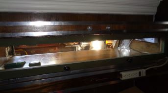

Looking from the inside, the previous owner had installed a screened opening to the rear hatch area. It maybe simpler to install a powered vent in the rear hatch cover to minimize the rework needed to install in the roof. Thoughts.?
Screened hatch.JPG (11.22 KiB) Viewed 846 times

cdnred wrote:Looking from the inside, the previous owner had installed a screened opening to the rear hatch area. It maybe simpler to install a powered vent in the rear hatch cover to minimize the rework needed to install in the roof. Thoughts.?
Possibly a very good idea. Perhaps the original builder/owner kept the hatch open at night to improve circulation? Honestly, I think you need to camp in it once or twice and see how it works as is.

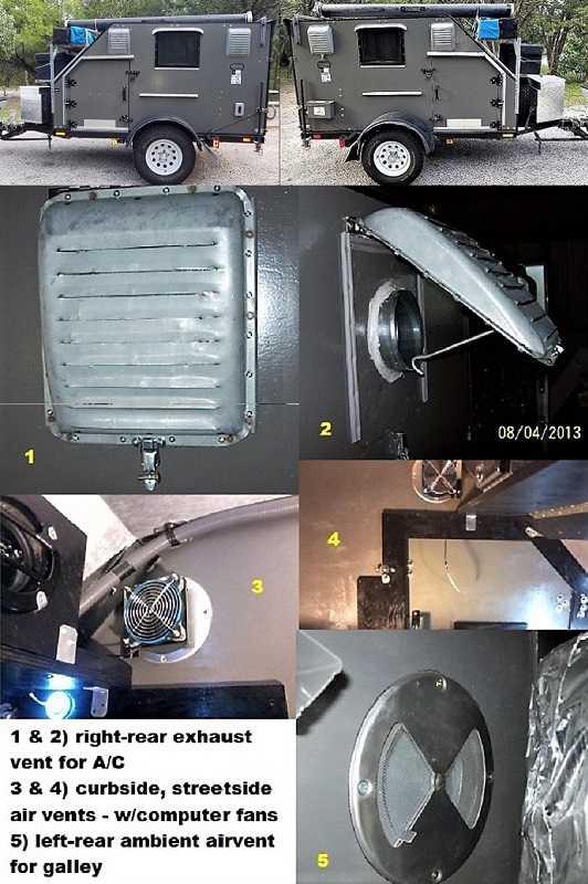

Here are three posts on other threads where I show my rain-proof side vents that I use in four positions on my 4x8 trailer:
The front two vents have 12vdc computer case fans (mounted on piano hinges) that enable me to use them to suck air in/blow air out (they're reversible) or swing away from the vents and aim them towards the inside.
There are two vents in the galley/storage area walls:
rain-proof vents.jpg (193.26 KiB) Viewed 715 times

Several reasons:
  • 1) My wife's business trailer (20ft Puma) had (a) a ceiling vent cover (plastic) break, and also (b) a leak around the cover. I was looking for a metal covered vent when I found the type I chose to side-mount, instead.
  • 2) I was in shipping/receiving at the time, and saw the vents I was choosing on many semi-trailers every day, some on their roof, and some on the front wall; neither placement site showed signs of water leaks.
  • 3) My trailer roof already had over a dozen holes in it already (though sealed with PL adhesive and silo paint, with clear acrylic laquer over that), so I decided not to cut a BIG hole up there.
  • 4) I was initially after an automotive/industrial look for my squareback, and those big, ugly, galvanized vents were just right, IMHO.
  • 5) I had thought I'd be going offroad at some point (never did), and wanted my vents "armored" as not to be broken by limbs or branches (I was fabricating hard window covers to protect the side glass, but never added them), so those vents were surely sturdy enough to withstand contact.
  • 6) Since those vents are proven rain-proof, I'd never have to close them ever at camp, unlike an overhead vent fan (my wife's vent had a "rain-proof" add-on cover, which didn't work). My vents don't leak.
