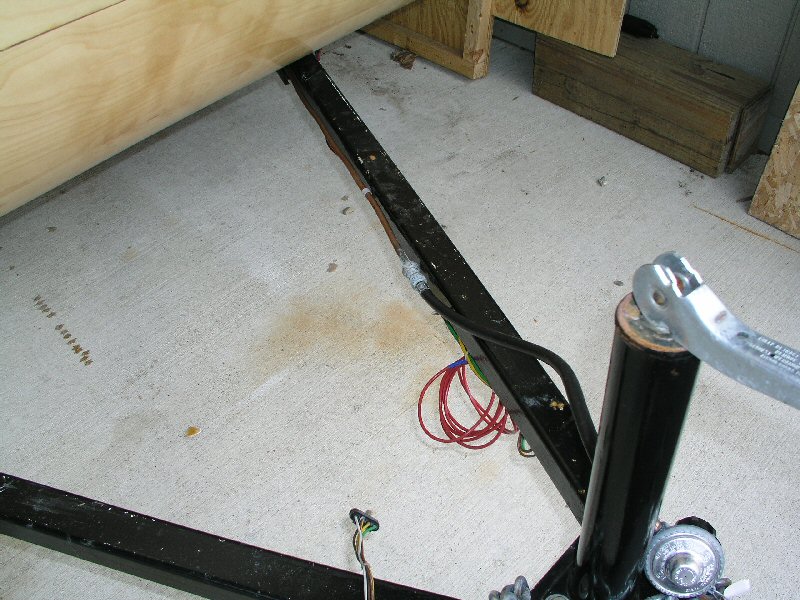

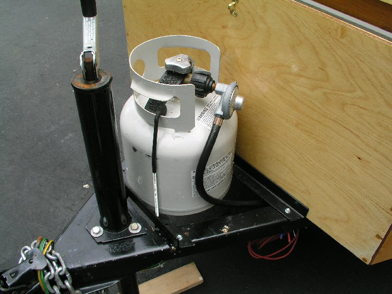

I ran a rubber hose from my bottle to the copper connection just under the front of the trailer. I'll look for a photo for you...

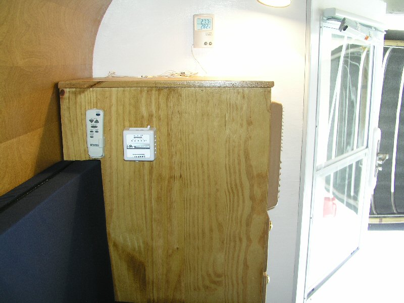

Okay, I was looking for this picture yesterday... or was it this morning? Anyways I just stumbled upon it... so here it is... my thermostat placement...

And here is the hose connection...
Postby southpennrailroad » Sat Dec 25, 2010 4:47 pm
mikeschn wrote:And here is the hose connection...
That's what I was after. Thanks

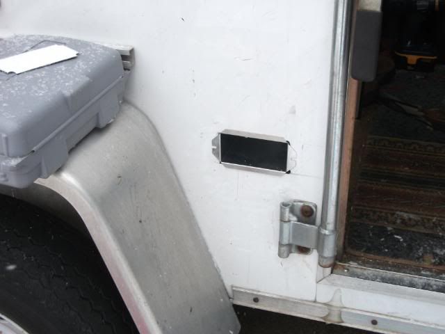

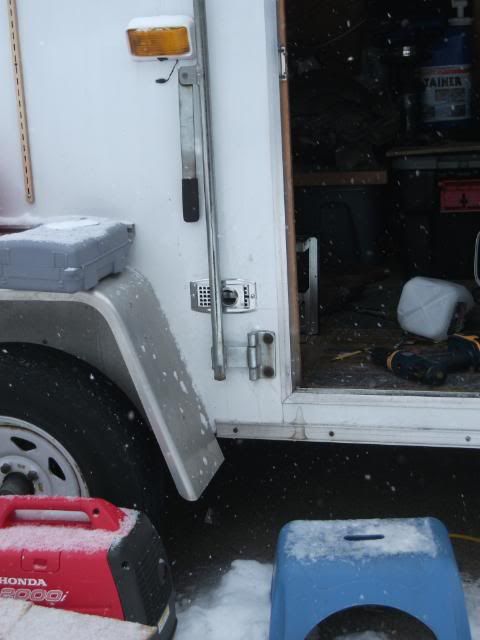

Postby southpennrailroad » Sun Dec 26, 2010 1:58 pm
Above The vents installed just behind the locking handle. No interference to air flow. Though close to the door it should not be a safety problem. I am going to install a down shield as well when it is done.

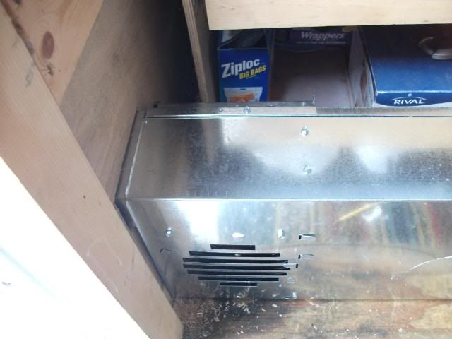

Postby southpennrailroad » Sun Dec 26, 2010 2:08 pm
I burned out the Dremil drill motor but the new wheels are great.
Here it is set to measure up how much to cut off the vent so the furnace would sit flush against the wall.
Above: The furnace installed against the wall. I installed two self tapping screws one on top and one on the side into the fresh air vent extensions.
