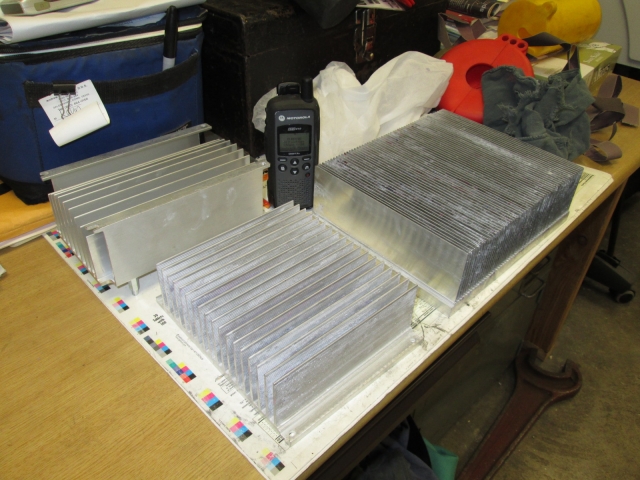

I did a little scrap bin diving at work and salvaged these heat sinks that were being thrown out.
These are usually from VFD's that have been "blown up", either from inadvertent exposure to water or accumulation of powders. The capacitors and some other electrical components have PCB's in them and by CT law have to be disposed of through waste management, so when one blows they strip the boards out and take the time to separate the aluminum out for scrap.
The walkie-talkie gives an idea of scale.

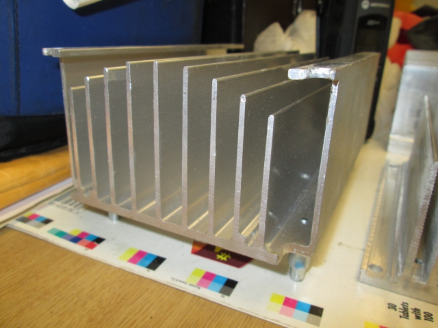

I like this one the best. It is over 3 lbs and is a one piece extrusion with extra ribs on each fin.

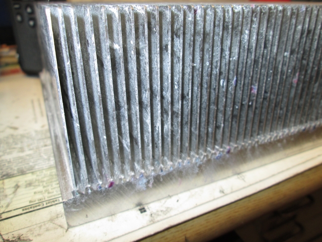

This was after I spent some time cleaning most of the organic color and guar gum powder off.

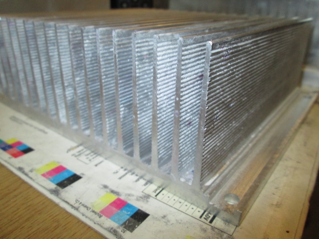

The big one has a lot more fins that are closer together, but they are crimped into slots in the extruded base. To me this means that there is at least a potential for a thermal barrier at those joints. I rinsed this one off some, but it was much harder to clean w/o having a soft bristle brush. Over 6 lbs.

The first two should be easy to incorporate into a baffled system where the flow path is directed back and forth across different sections of the fins, making a multiple pass configuration.
I won't get to work on this idea until further down the line in my build, but I wanted to throw the pics up as food for thought.
I'm going to hang on to these until I know which one will work best for me, but I'll keep my eyes open and if I find more I will offer them up to interested parties. ;)

mikeschn wrote:KC, Do you think those fin thingies would help with a candle heater?
Yes. They are designed to work in the reverse; you bolt a heat producing electrical device (power supply transformer, or in the case of a VFD, a square wave inverter) to the plate side with heat transfer compound between them (to bridge the natural thermal barrier of the boundary layer between the two) and the heat is radiated out thru the fins by conduction. The fins are oriented vertically so natural convection (heat rising... usually enhanced with a fan) can dissipate the heat out of the fins.
The beauty is that this should also work in reverse. Direct the heat from the candles past the fins in a serpentine fashion and the heat will be collected into them and conducted to the plate where it can radiate out into the cabin. It is a way to expose a much greater surface area to the heat source in a smaller package.
In describing this, it occurs to me that it would be very nice to have two identical heat sinks. Attach them back to back with heat paste between. One side collects the heat and the other radiates it into the cabin. :thinking: :thumbsup:
Further, I think it would be beneficial to build the box to incorporate the heat sink(s) as one of the major surfaces, rather than just attaching it to one of them (i.e. build the box out of the heat sink, rather than attaching it to the box). This would eliminate a thermal barrier that might otherwise exist between the heat sink and the face of the box.
I wish I had another one of the medium sized sinks.
