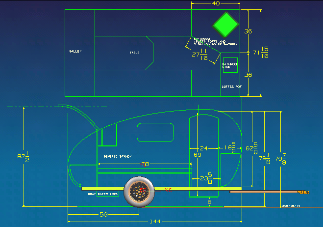

What ever it takes to get to about 6' wide.
If you use a flexiride axle and 14" wheels, you can use a 54" wide chassis.

I really like the drawing, with the bathroom and cooler, what size beds are being used? So its 6 feet wide 10 feet long???????

Pod... Great floorplan , and the sink too ...!!! :) ... and see, such a neat drawing...:roll:
Using Pods floorplan ...figure the beds are 76" long (for me) the sink area would be nice at 36" and the shower at 36" will put the trailer about 12.5 ' long...certainly not too long ...

I tweaked design a little bit to get it into 12' of length. Then I tweaked the profile a bit to make it look more "teardropish".
Opps, don't mind those vertical dimensions at the front... I have to re-attach them.
The rear two thirds of the trailer is teardropish, and the front third is all about convenience.
Imagine GPW's pencil drawing of the bathroom for that corner in the floorplan.
I made the hatch only come down to the counter, and the space underneath can be accessed from the outside via a small door, or an access door in the counter.
The front will have a storage box, though that is not shown on the drawing yet.
So will this design be good for 99% normal camping and 1% bugging out? What do you think?

I like it very much indeed!!! :thumbsup: :thumbsup: :thumbsup:

Hmm, looks like a TAB clamshell:

Mike... I absolutely think you have a winner there! Best of both worlds...
A great "bug-out" trailer AND a darn neat teardrop camper too. You have enough "galley space" you could cook and eat inside when the weather is lousy... And you still have enough outside galley/storage under the hatch so you could use it like a normal rear galley when the weather is good and you so choose. Plus, the shower-potty means you are really self contained even in a wally-world parking lot. That setup is about as much as anyone could ask for... Cool Beans! :applause: :applause: :applause:

:thumbsup: ...by jove I think he's got it...cooking space both in and out...a dinette for those nasty days, a place to stand(sorta) while pulling on your pants and a bath for those folks that
REALLY need one..........

Mike, flatten the front and call it the Jumbo Dandy!!

Mike - can the toilet be where you have it in that drawing? According to the plans, the toilet would be in the curve part of the bottom. There is no trailer there, that would be curve, unless I'm looking at it wrong. It would work that way if you got rid of the bottom curve and came straight down.
You could always add a small skirt below the frame to carry the curve through, like Les Lampman's new design.

There is no curve on the lower front. It just looks that way.
Bruce,
Yes there is a strong resemblance to a Tab Clamshell. But the tab clamshell has no bathroom.

Mike , that's super.... but I still think bunks would leave room for my Lazy Boy recliner... :roll: ..... :lol: Half the storage space with bunks , but that's why we have cargo nets by each bunk ... very practical ...

P.S. Since the dropped floor doesn't work on a red trailer, I'm currently working on a split floor design, with a flexiride axle at 22 degrees up start angle.

Do you really need a dropped floor??? why not just make it taller ...??? gonna' have to splice plywood anyway...
