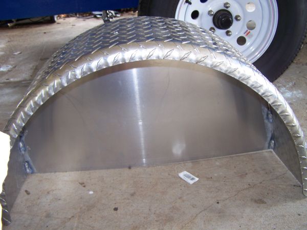

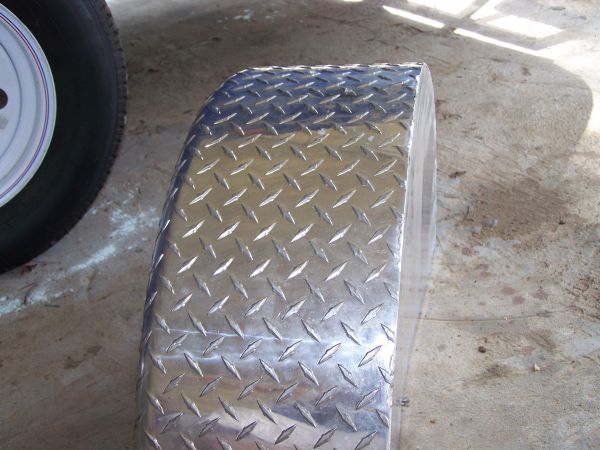

Ok the day is here that i either have to trash the fenders i have and start All over or move forward.. Here are some pictures of what i have now after the welder modified them as i asked. What i did was cut one side and had him weld in a plate at the back so the fender would sit flush to the side of the trailer.. My plan is to use some silkaflex and maybe a few stainless screws to hold the fender to the side of the trailer at the top. Then have the welder build two brackets for the bottom to bolt two. I had to notch the back plate out for it to fit over the axle.. Any feed back on either the fenders or on how you would mount them would be welcomed...
Fenders
Back plate
Here is a mock up of what it might look like..

Postby Esteban » Mon Oct 06, 2008 3:30 pm
Eddie wrote:Any feed back on either the fenders or on how you would mount them would be welcomed...
Eddie, your new fenders look good. It adds a rugged look like you're ready to take the teardrop into some back country areas with dirt roads and brush.

Postby Eddielbs » Mon Oct 06, 2008 3:36 pm
Did you install wood blocking inside your sandwich walls for the fenders?
Thanks Steve, I really just can't make my mind up if i like them or not.. To answer your question, no i didn't and that is something i regret now.. All i have to work with is 1/2inch outer layer.. thats why I'm planning on making the fender brackets at the bottom to help with the stress.

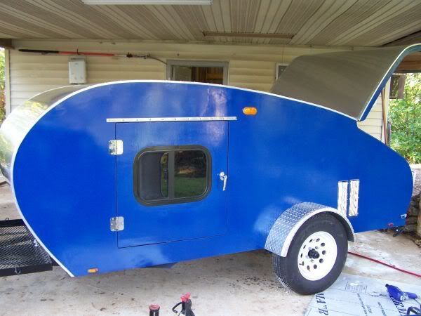

Those diamond-plate fenders look great!

hiker chick wrote:Those diamond-plate fenders look great!
hiker chick's enthusiasm is catching. I agree. It looks great, Eddie and Anna! :applause: :thumbsup: :applause: :thumbsup: :applause: :thumbsup: :applause: :thumbsup:
Your color theme seems to be shiny metallics, with deep blue painted sides, and some white accents. The metal diamond plate fenders add a strong metallic punch and visual color balance to your teardrop.

Fender Poll
Postby Eddielbs » Tue Oct 07, 2008 1:42 pm
Ok i just couldn't make up my mind on the fenders so i started a poll and got lots of great feedback.. If interested you can find the info Here But the nuts and bolts of it is that i just ended up cutting the fenders.. like this

Postby madjack » Tue Oct 07, 2008 10:25 pm
...good job and a good look...I like it :thumbsup: :thumbsup: how are ya mounting them ............... 8)

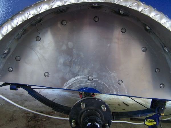

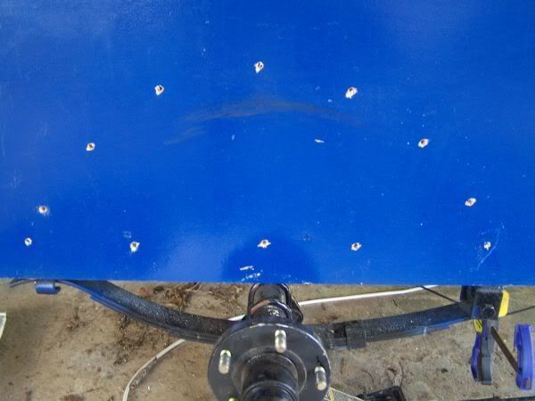

Postby Eddielbs » Wed Oct 08, 2008 6:51 pm
madjack wrote:...good job and a good look...I like it :thumbsup: :thumbsup: how are ya mounting them ............... 8)

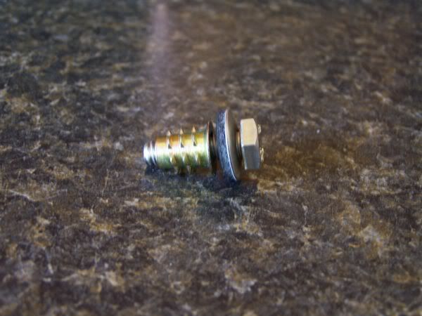

I did it like this.. I hope it holds i tried one of these in a scrap piece of wood and couldn't pull it out with vice grips. I have 12 on each fender along with some of the same caulk i used on the roof skin.
Here is what I'm using to attach the fenders to the wall..
EZ-Lok type nut that is threaded inside and holds really well in the wall
Here is the wall predrilled before i screwed in the Ez LoK nuts. I placed some sealant in the hole then the Ez-Lok
I plan on using some of the spray rubberier undercoat inside the fender well.
Installed

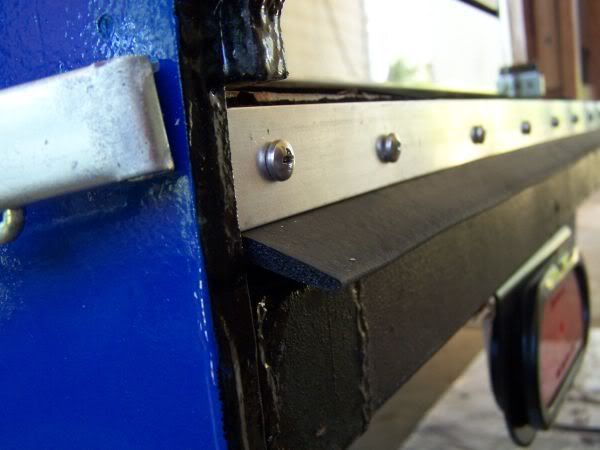

Hatch Seal..
Postby Eddielbs » Wed Oct 08, 2008 7:25 pm

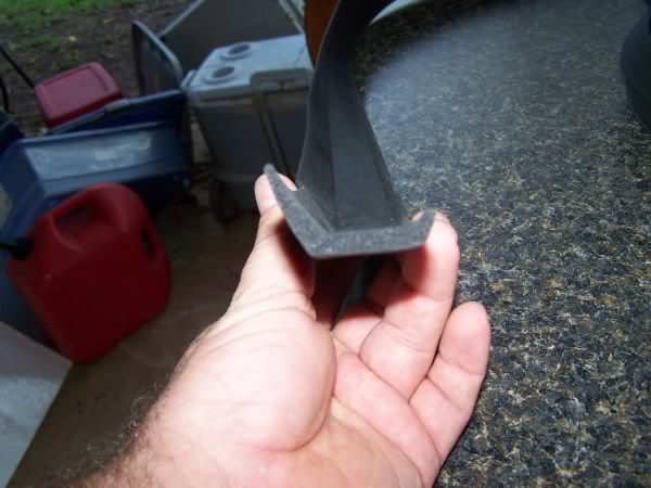

I also installed a seal for the bottom of my hatch.. I used a garage door seal and a piece of flat bar.. Heres how it turned out.
Type seal used.
Seal install from the left.. What happens when the hatch is closed the flat part of the 2x4 presses down the seal and holds the water and dirt from getting in the bottom.

Postby madjack » Wed Oct 08, 2008 7:58 pm
Eddie, I have used those inserts on other jobs and they worked very well...I don't think you should have any problems with those fenders staying in place...as the saying goes...there is more than one way to skin a cat!!!!!!!!
