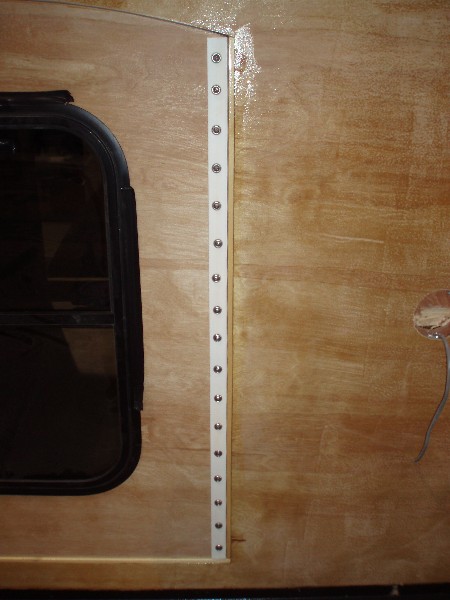

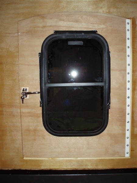

Yep, three colors to choose from. I got mine in yesterday from Mcmaster-carr, when I opened the box, I thought I must be the biggest fool there ever was. How is this little strip of plastic going to hold a hatch. But when I come on here and see that it is what is being used, I feel a little better now. Now if I just had a hatch to attach it to.....
madjack wrote:mechmagcn wrote:madjack wrote:I believe it comes in black, white and possibly grey................

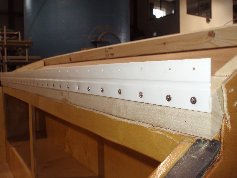

Jeff, as long as you got the "harsh environment" hinge from McMaster or the "living" hinge from Monroe, you have the right stuff...

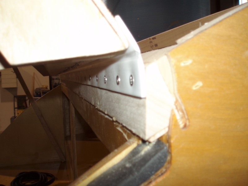

Walt M wrote:Jeff, be careful about attaching the hinge to the hatch. whether you call it a spur or rail but the first cross member that butts up against the roof spur. they are both cut at an angle. It does not leave much to attach the hinge to, I used #8x3/4" . the 1" I started with poked out through. Walt
